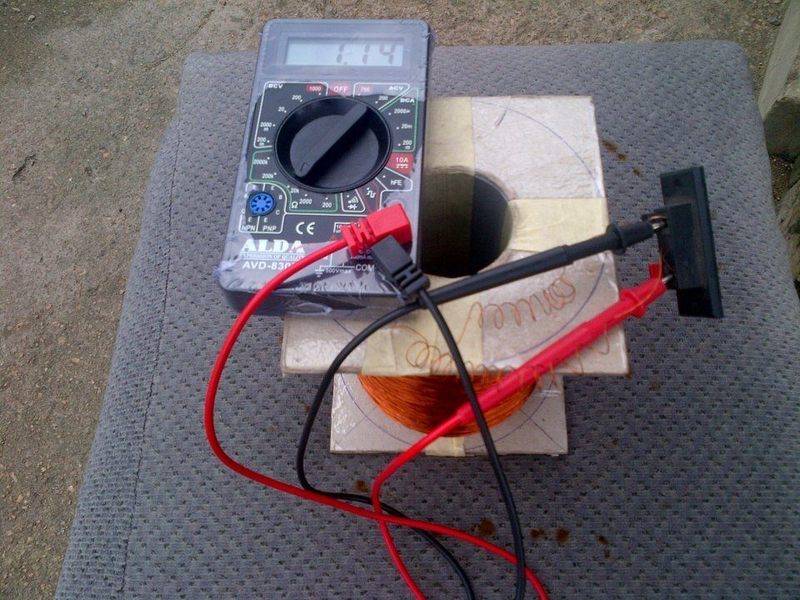

I actually get there from Google and what I am deeply curious to know about is the amount of Maximum Voltage my 3.5kg Air Core Electromagnet can bear.
The Core of the Solenoid is 120mm in height and 13inches in Diameter.
It core is 47mm wide and 130mm long.
I used 0.31mm thick enameled copper wire to make it and after winding it reads 1.14KOhms.
Please may I know the maximum Voltage to apply to it in other not to get it burnt?
How do I calculate that?

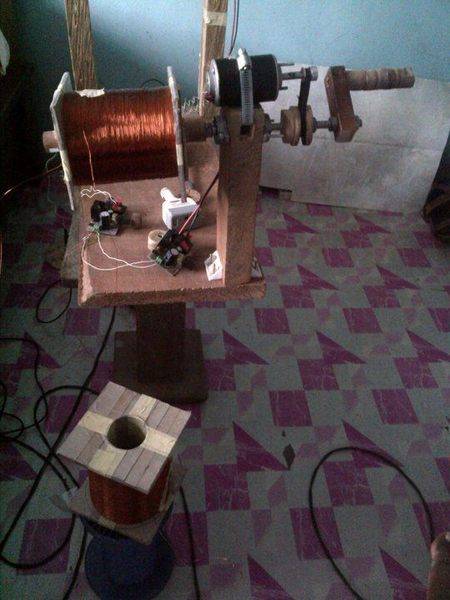

Photo of an air-core solenoid wound with orange enameled copper wire on a cardboard former, sitting on a wooden desk with electronics and a plastic bucket nearby.
Homemade wooden coil winder with copper wire spool on a rotating shaft and a motor-driven crank, beside a small wooden-core air coil on a floor with purple patterned tiles.
  • Digital multimeter with display reading 1.14 resting on a cardboard-core coil of orange enameled copper wire, with red and black test leads clipped to the coil ends.

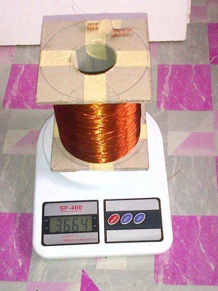

  • Photo of a large spool of orange enameled copper wire on a digital kitchen scale reading 3664, with a small cardboard former bearing a coil of wire on top.
Sorry people, I'm wrong by saying the Core of the Solenoid is 120mm in height and 13inches in Diameter.
What actually mean to say is the Air core Windings is 120mm in height and 13inches in Diameter.

The voltage handling will be determined by the insulation on the wire and by the temperature.
Heat generated will be w = I2R and must escape somehow. Temperature will be determined by heat generated and thermal conductivity.
If you disconnect the coil while a current is flowing, the coil inductance will produce a voltage spike that may puncture the electrical insulation. For a DC coil you should have a “flyback diode” to prevent that spike.
What is resistance of the coil at what temperature?
What is the insulation and temperature rating of the magnet wire?
Na way any part of the solenoid as shown has 13" diameter if it is 120 mm high. Perhaps you mean 13" circumference?
You need to know the rating for the insulation of the wire you are using. For example, Polyimide insulated magnet wire is capable of operation at up to 250 °C.
To calculate the power required to cause that increase you need to know the thermal conductivity from the coil to the ambient. I don't know how to calculate that, or whether there are rule of thumb numbers based on exposes surface area. Also, you need to understand the internal heat transfer through the layers of insulation and wire to determine the internal temperatures.

But I after I finished winding the coil and supplied 500vdc (using capacitor voltage doubler) to it via the wall AC mains, it bears the voltage. But when I allowed it to stay powered up longer for about 2mins, it temperature start to rise. But when I use a battery powered inverter, it takes longer at same voltage before it starts to get Hot.
