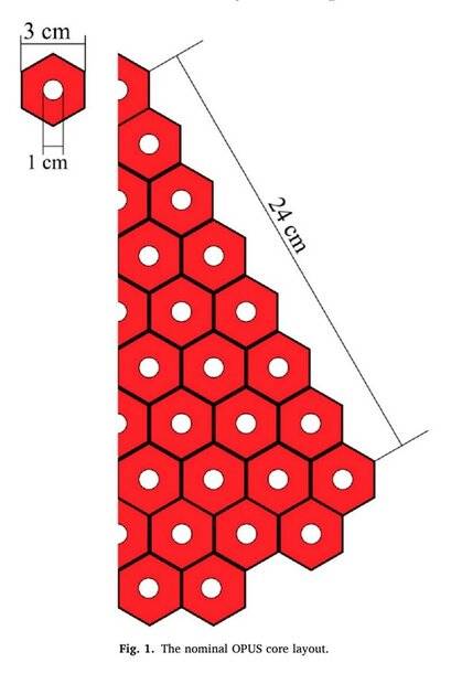

Hello!
I tried modeling a space reactor core with MCNP. I'm pretty sure the geometry and material properties are correct.
Got k_eff of 1.4, much higher than 1.003 from the reference.
Could anyone spot the mistake in my code? I couldn't figure out anything else

If the core is supposed to have an excess reactivity of 3000pcm (I googled), isn't that a keff of around 1.03? Presumably that is with the reflectors.
The fuel is graphite with 45%vol UO2 BISO particles, not solid UO2.
You have cookie cut the core a bit weird. You may need to abandon the segment method and define the lattice.

In your lattice example you tried -9:-7:-5:-3:-1:501, -9 is inside macro body surface 9. -7 is inside macro body surface 7. You can't easily fix this, the use of macro bodies placed inside the core is going to make defining the missing volume complicated.
My thoughts are to make a universe of cooling tube surrounded by core rod material, specify those in a hexagonal lattice which does the hexagonal cookie cutting, then surrounded by a cylinder. Your core then has the right shape, the cylinder isn't cutting into the actual rods, and volumes like the void become easy to define and it can be easily extended to cases with rods of mixed lower enrichment.
Firstly I was wrong that your experiment is not limited in z, surface 2 is a macro body and it does do this. Do watch out if you ever need to add a reflector!

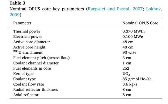

Almost all the information I can find on OPUS comes from "The challenges of gas-cooled reactor technology for space propulsion and the development of the JANUS space reactor concept" by Aiden Peakman and Robert Gregg. I can't find copies of the Raepsaet and Pascal, or Lokhov papers that are the primary sources for the information on the core. The core diagram we do have contains a measurement of 24cm, and I question why it isn't 21cm (3x7) or there isn't an extra layer of rods around, and I can't make the number of fuel rods add up. The 235 rods, which is the design the diagram seems to indicate, without reflector ought to be subcritical and it isn't (keff=1.07).
So I made a few tweaks to the input file. I kept the segment design. I flipped surface 501 around so it aligned with lattice numbering better. I'm using my rough numbers for material values which may be very rough and lastly I may have made any number of mistakes.
Major edit - I did make mistakes, I messed up the rod count on the version I uploaded by a lot. I think it's right now.

The paper seems to indicate they used the 1/12 simulation as a coupled thermodynamic/neutronic solution for thermal tests but they don't give a keff. The keffs they give are for the core in four quarters design with more rods (4x63 total) and reflectors around the edge, above and below. There is a lot more space in the middle of the core with no fissile material so that has a good chance of being under critical like it's supposed to be.
