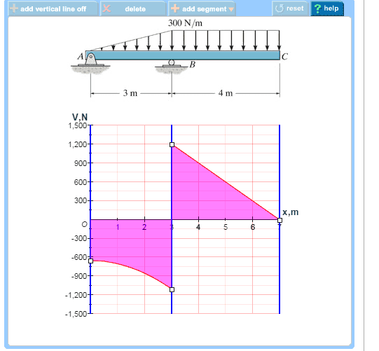

The first segment starts at -650 and ends at -1100.
The second segment starts at 1200 and ends at 0.
dM/dx = V
I attempted to break the problem into two parts.
For the first segment:
Skipping a few steps:
w = 100x
dV/dx = -100x
V= -50x^2
This is where my first confusion arises.
If dV/dx = -w
then how can the solutions guide say
Sum of the forces in Y = 0 = -650 - 50x^2 - V
V= -650 - 50x^2
Now I have two things that V is supposed to equal...?!Moving on:
dV/dx = M
M = -650x - (50/3)x^3
So the first segment starts at 0 and ends at -2100 which I got from plugging in x=3 into my moment equation. It is a cubic function that has an increasing negative slope as it approaches x=3.For the second segment:
V = -300x
Sum of the forces in the Y = 0 = -650 +2300 -300x - V
V = 1650 - 300x
M= 1650x - 150x^2
but now I'm not accounting for the first part of the beam. I'm completely lost at this point.

It's best to start off with the basics:
The beam must be in static equilibrium in order to be analyzed. What reactions have you calculated at points A and B to put the beam in equilibrium?
There are no forces in X.
Ay = -650 and By= 2300.
Start at point A. If you accumulate the distributed load w over the interval 0 < x < 1 meter, how many Newtons is this?
300/3 = w/x
w= 100x
from 0 to 1, w= 100N.
Feodalherren said:
300/3 = w/x
w= 100x
The distributed load at x = 3 m is w = 300 N/m. By ratio, the distributed load at x = 1 m is w = 100 N/m. Note the units here. w is not the total load over the interval 0 < x < 1, it is just the ordinate of the distributed load curve. In order to calculate the total applied load on this interval, you must find the area under the distributed load curve, which is 100 N/m * 1 m * (1/2) = 50 N.
At x = 1 m, the shear V = RA - 50 N = -650 - 50 = -700 N, which should plot on the shear diagram shown in the OP.

I drew that diagram :). The shear part was pretty straight forward although I had some confusions that you cleared out.
Now to the hard part, the moment diagram.
How do I go about finding the moment diagram?
It is the integral of the shear diagram so for the first part it should just be
M = -650x - (50/3)x^3 ?
Okay fine, but for the second part.
M = integral of what!?
I found that the second equation should be V = 2100 - 300x
from y=mx + b where m= -300
Ay V=0, x=7 therefore b=2100
but that gives M= 2100x - 150x^2 which doesn't yield M=0 at x=7.
This expression for the bending moment is valid on the interval 0 < x < 3 m.
Once you have found the bending moment at x = 3 m, you continue calculating the area under the shear curve for x > 3 m. This area is then added to the bending moment at x = 3.
The equation M = 2100x - 150x2 is valid only for calculating the area under the shear curve in the interval 3 < x < 7 m.
Let's call the bending moment equations as follows:
M1(x) = -650x - (50/3)x3, for 0 < x < 3; and
M2(x) = 2100x - 150x2, for 3 < x < 7
Both of which are derived by integrating the shear force curve.
In order to find the bending moment in the interval 0 < x < 3, you would simply calculate M1(x). Once x > 3, then the bending moment is calculated as follows:
M(x) = M1(3) + M2(x) - M2(3), for 3 < x < 7.
As an example, for x = 7 m, the bending moment is
M(7) = M1(3) + M2(7) - M2(3), where
M1(3) = -2400 N-m
M2(3) = 4950 N-m
M2(7) = 7350 N-m
So that M(7) = -2400 +7350 - 4950 = 0 N-m, as required.

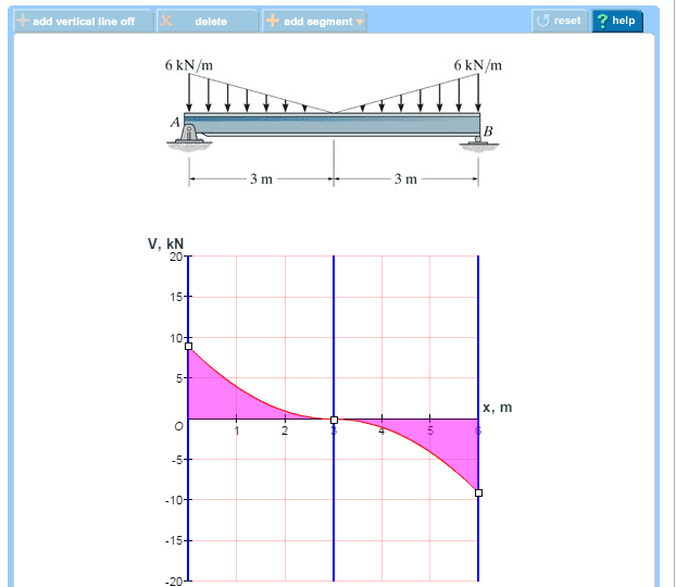

What the heck...?! It doesn't work for this one:
I was able to solve it graphically but if I use the same steps
w= 2x
Vx= -x^2
V = 9 - x^2
clearly that is not the graph, it is (x-3)^2=V
w= 2x
Vx= -x^2
V = 9 - x^2
You're still trying to eyeball these problems and not work them out in a systematic fashion.
Look at the distributed load for the interval 0 < x < 3 m. Is w = 2x? I don't think so. If x = 0, then w must equal 6kN/m. If x = 3, then w = 0.
What sort of equation must you write to make these two facts true?
I'm absolutely not. I tried going back and using the same exact method that we used on the previous one.
I think I see my mistake now though.
Vx = 6-2x
So the ratio only gave me the slope and I have to find the Y-intercept.
V = X^2 -6x + 9
I see. Thanks again and thanks for your patience.
