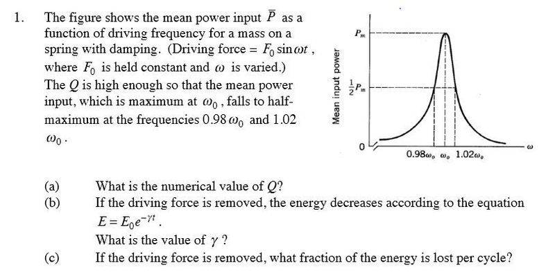

I'm working on part a.
The numerical value of Q.
I have an equation stating that Q = ω_0/ϒ.
I don't really know what ϒ is, in other places (http://farside.ph.utexas.edu/teaching/315/Waves/node13.html) it seems like the frequency.
But, I also do not have w_0. So perhaps this is the wrong equation or perhaps I am looking at it wrong.
I also have: P_max = (1/2) * (Q*F_0^2)/(m*w_0)
but I do not think this helps directly.

Correct. What would help is an expression for P as a function of ##\omega##. Because from the picture you can see that P halves when you are ##\omega/50## away from ##\omega_0## ...

P(w) = F_0^2*w_0/(2*K*Q) * [1/((w_0/w-w/w_0)^2 + 1/Q^2)]
At w = w_0, we get it to be maximized.
P(w) = F_0^2*w_0*Q/2K
i'm not entirely sure how this helps, tho.
As we do not know F_0, other then that it is held constant.
w_0 is unknown, but you are saying that P halves when we are w/50 away from w_0. Why 50?
If we take (1/2)*P(w) = F_0^2*w_0*Q/4K
That doesn't seem to help.
I am guessing that I am not making a connecting between F_0, K, and w_0?
From the picture we see ##P(\omega_0 + \omega_0/50) = {1\over 2} P(\omega_0)##. A lot of the factors that bother you divide out when you work out this equation...and who knows, you end up with something containing ##Q## ...

It would be instructive to look up the definition of the Q factor. There is a definition that involves bandwidth (-3 dB, or half-power points) that will be of particular interest.

Sure you would! Q has a definition in terms of the bandwidth. The bandwidth is defined in terms of the half-power points. You are given the half power points on the diagram in terms of the resonant frequency ##\omega_o##. So, what's the bandwidth on your diagram?

0.04w_0 = bandwidth = Q ?

Go back to the Wikipedia page and look at the definition of Q in terms of the bandwidth!
Aha.,
f_0/The change in frequency = Q
So, w_0/0.04*w_0 = 1/0.04 = 25 is the value for Q!

Huzzah! Yes!
