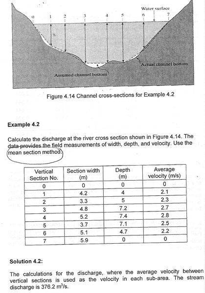

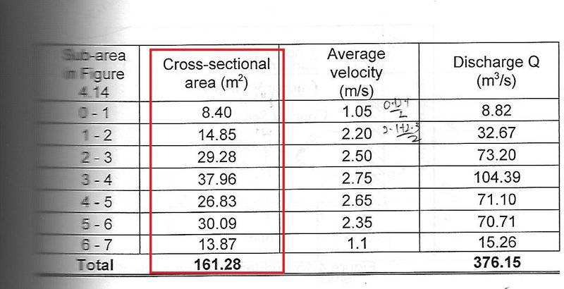

I have problem of obtaining the cross sectional area .
Taking section 2-3 as an example , my working is [ (3.3 +4.8) / 2 ]* 5 = 20.25 , but the ans provided is 29.28 , how to get the 29.28 ?

In section 2-3 the depths are
5 and 7.2
So the average depth is
(5+7.2)/2=6.1
The width is 4.8 so the area is 4.8*6.1=29.28
