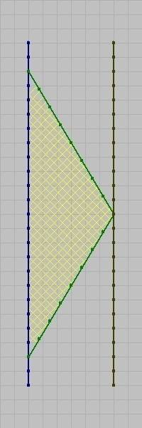

Look at this diagram. Can you say what the time is on Greens clock at the event when the first light pulse intersects with the green WL ?
Mentz114 said:
You don't have to apologise for calculating the intersection of two lines.
Because you once said something like "Don't say cartesianing ST diagram, this is nonsense." :smile:
What?? Where did you get this picture? Upload ST-03.txt and you'll see. Open "Original Source for ST-03.txt" in notepad. Don't open it in ST plotter. This is my original number. You'll see that I use 1500 and 1700 coordinate to match ##v = \frac{15}{17}c## I haven't upload it yet at PF Forum. I still have a question regarding pervect post. But your post came before I get the chance to finish my question.
Okay where it intersect Green Line? At (9.5,9.5) [(796.875, 796.875) according to my numbers].
But I have to count each square carefuly. I tought it was 10.5, not 9.5. Second calculation gives 9.5.
It's still a good software. If I "match speed" it, it will show the Lorentz transformation for one. And it helps me much than drawing ST diagram in Microsoft Excel or in Microsoft Paint.

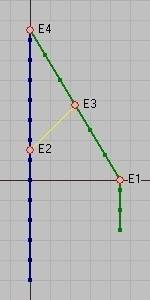

Dear PF forum,
Before I ask further, can someone explain to me about time dilation?
This problem is similar to Post - #84
Rather than starting at -1 second where we already know when Blue (B) and Green (G) will meet, I started the clock at 0, so we won't know at first when they will meet. "Nature can't be fooled."
Green (G) moves at 0.6c; ##V = -0.6; \gamma = 1.25##
The distance before Green starts to move is 900 ls
From Blue (B) frame,
E1: -900
E3: 900
E4: 1500
From Green (G) frame
E2: 0
E4: 1200, again if E2 is 0
Clocks are NOT synchronized, is this important?
Okay,...
E1: B:-900
B sends a signal to G, containing B clock's: B:-900
E2: G:0
G receives the signal from B, reads the data B:-900, G sends the signal to B, containing G's clock, G:0
Is it relevant for G to compare B:-900 with G's clock? I think no, because their clocks are not synchronized. G can only write (B:-900;G:0) in G's notebook.
G knows that B is moving toward G their distance is receding by 0.6c because of Doppler effect, is this true?
E3: B:900
B receives the signal from G, reads the data G:0,
Is it relevant for B to compare G:0 with B's clock? Again, I think not. B will write G:0; B:900 in B's notebook
B knows that G is moving toward B their distance is receding by 0.6c.
E4:B:1500; G:1200
B and G meet:
B reads his notebook
E3: When B is 900s, G is 0
E4: When B is 1500s, G is 1200
##\Delta t_b = 600; \Delta t_g = 1200## What is this? G's clock runs faster then B's?
G reads his notebook
E2: When B is -900s, G is 0
##\Delta t_b = 2400; \Delta t_g = 1200## B's clock runs faster than G's.
The situation from E3 and E2 is symmetrical both for B and G. ##\frac{1}{2}##
But from G frame, it's B who moves, right? Motion is relative, and the clock for moving object runs SLOWER, not faster?
Is this how B should reconcile?
At E3, B receives the bounce signal that B has sent at -900 (E1),
##\frac{\Delta t}{2} = \frac{1800}{2} = 900##, so B knows that actually G received the signal 900 seconds ago E3. So the distance where G received the signal is 900 ls away when B clock reads ##900-900=0##.
At E4, when they meet. B see G clock is 1200, and comparing to his notebook E3: G Clocks -> 0. B clocks read 1500 at E5
So ##\Delta t_g = 1200##, while ##\Delta t_b = 1500##. So this is actually G proper time where B receives G signal at E3. Is this true?
This clocks conform gamma factor. ##\frac{1500}{1200}=\gamma = 1.25##
How B should reconcile? I can't find the solution here.
The situation should be symmetrical, right?
Thanks for any help.
For post #98, in blue's frame we can write:
##(E4 - E3) = k^2 (E4-E1)##
where k is the doppler shift factor, ##\sqrt{\frac{1 - \beta}{1+\beta}} = \sqrt{.4 / 1.6} = 0.5## in this example, since ##\beta = v/c = .6##.
Here E1, E3, and E4 are time coordinates along the blue worldline, which are the reading of the blue clock at the specified events. It might be clearer to write timeof.E4.in.blue.frame instead of just E4, but that's too much work, so I just wrote down E4 , etc, and explained.
Note that E4-E1 is just the proper time along the blue worldline until it meets the green worldline. If we don't know when the two worldline's meet, we calculate that first (calculate E4), then use the above formula.So it's really not that much different, we use the same basic idea.
Similarly, we can write that (E4-E2), measured along the GREEN worldline, is equal to k*(E4-E1), measured along the blue worldline.
We can write down a few other things, too:
In the blue frame, ##E2 = (E1 + E3)/2##, which is zero in your example. We also know that the distance from blue to green in the blue frame at time E2 is given by the relationship 2*distance = (E3-E1)
That's pretty much all we need to solve the problem, as far as I know. I'm not quite sure what you're puzzled about.
The logical justification for the above formulae is just the fact that the relative velocity between blue and green is constant, implying that the doppler shift is constant, and that fact that for every transmitted signal, there is a unique time of reception, a 1:1 mapping.
Post #99
pervect said:
Similarly, we can write that =>(E4-E2)<=, measured along the GREEN worldline, is equal to =>k*(E4-E1)<=, measured along the blue worldline.
That is not what I asked for. The point of intersection is not the time on the green clock. That time is given by the marks on the green worldline.
So the elapsed time on the green clock between the start of the WL and the intersection with the light is about 4.9/20 which agrees with your k-calculation of 0.25.
I don't think you understand yet what proper time is.
Sorry, I hastily calculated.
About 4.8 or 4.9?
[Add:] And the close the angle to -450 the knots will be separated farther and farther?
[Add:] Oh I see, with my spread sheet, it will be difficult to see the 4.8 and 4.9, I have to transform it manually according to Lorentz transformation boost in the x-direction.

The knots as you call them are the ticks of the green clock. If you count up it comes to about 4.9 and to get seconds we divide by 20 because we decided that 20 ticks is one second.
It is important to understand that every clock tells the proper length of its worldline. This is a big change from Gallilean relativity.

Wait, I'll a draw a Twins Paradox world lines
Stephanus said:
Hmhhh, all this time every time I calculated time, I used the reverse of pythagoras. ##t' = \sqrt{y^2-x^2}## How can I didn't see the knots before? :smile:
Btw, this is my source numbers and the resulting text files. You might want to rename Source ST-03.txt to Source ST-03.rtf, because PF forum doesn't allowed uploading RTF files.
I wondered why you didn't see the 'knots'.
You have made the connection with proper time, ##\tau = \sqrt{t^2-x^2}## which is good.
I'm not going to download any of the stuff you posted. I find your methods complicated and baroque but if it makes sense to you then that's fine.
Twins paradox
There is something very wrong here?
Those I area that I circle. Why there are so much lines? I've calculated my numbers twice (may be three times) But the lines at the red circle are crowded?? I'm afraid there's something in my text files that ST Plotter won't receive.

Stephanus said:
What about this? This looks right to me.
That looks OK. But, as usual, I'm wondering why you need all those light pulses ?
The time between parting and meeting on the blue clock is the number of blue knots between the events, and the time on the green clock is the total number of green knots.
You could also calculate the green clock times using ##\tau=\sqrt{t^2-x^2}## for the green triangles.
