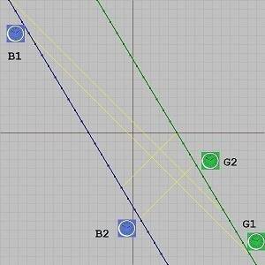

Stephanus said:
Finally...:oldeyes:As long as the clock moves along with the observer, right?I want to ask something here.
Okay,... Blue and green move at the same velocity.
1. Can we say that blue and green are at the same frame of reference?
2. G2 will see Blue as B2, and B1 will see Green as G1, is this true?
3. If number 1 is true, can Blue use Green time as proper time?
Thanks.
It is not strictly true to say that something is 'in' a frame of reference. The whole world covered by the coordinates is 'in every frame'.
Green and blue are comoving, They have zero relative velocity, ##\gamma=1## and so their clocks and rulers are the same..

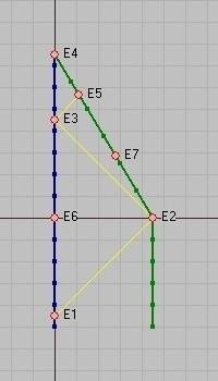

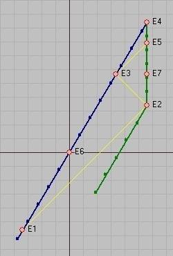

From your diagram we can say that if green sends a beam of light to from G1 to blue, it arrives at event B1. If blue sends a beam from B2 it arrives at event G2.
This scenario tells you more. You can see a symmetry between green and blue because the are comoving. From any frame the times on the clocks of green and blue at all the events will be the same, 0 for B2 and G1, and 6 for B1 and G2. All proper times are invariant.
Spacetime diagram with two vertical worldlines, blue on the left and green on the right, and a red line on the far right. Yellow light paths cross between points B1, B2, G1 and G2 in an X pattern.
Spacetime diagram with two near-parallel worldlines, blue on the left and green on the right, and a red vertical line on the far right. Yellow light rays cross between labelled events B1, B2, G1 and G2 on the blue and green lines.

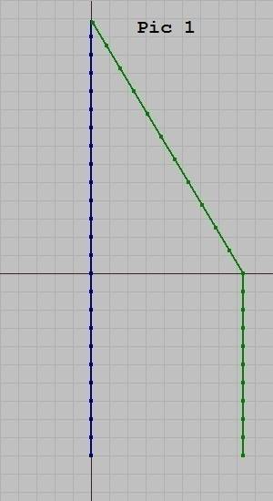

If we have two observer (B) Blue and (G) Green.
- They are at rest,
- Clocks are synchronized (is this related to our discussion? I don't think so, but I'll write anyway)
- Then at a preagreement time, G moves toward B at 0.6c ##\gamma = 1.25##

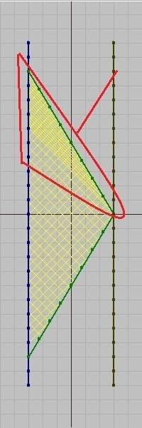

What is the correct way to draw the ST diagram?
Spacetime diagram with a vertical blue world line at left and a green world line that starts at top left, slopes down to the right, then turns vertical at a kink near the axis crossing.
or
Spacetime diagram with a vertical blue line for the stationary observer's world line and a green diagonal line for the moving observer's world line, which the green horizontal segment at the lower right appears to show as a shorter spatial segment; labelled Pic 2.
Because "they" said that for the moving object the length is contracted, but then again I remember

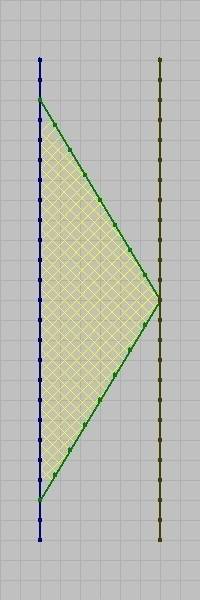

Spacetime diagram with a vertical blue world line for observer B at left and a green world line for G at a slope, with a green segment and red light ray near their intersection circled in red.
I purposedly add the wider green world line (see red circle), because "they" said that for a moving object, there is simultaneity of event. So the "distance between Geneva and Lyon is not contracted", but Green does have already moved several distance when Blue receive event G, see the wider green line.
And in Picture 4, I tried to draw light rays, but there is something that doesn't make sense.
I drew light cones for events on Green world line, namely
G-3, G-2, G-1, G0, G+1, G+2, G+3. Each one representing each second for Green. And each event on green world line corespond to Blue world line
G-3 -> B-3
G-2 -> B-2
G-1 -> B-1
G -> B
G+1 -> B+1
G+2 -> B+2
G+3 -> B+3,

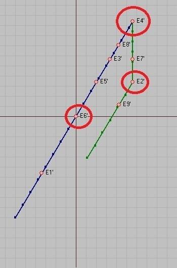

But if Green moves, it seems that even if G-1, takes place before G+1, but B+1 takes place before B-1. Where did I go wrong?
Spacetime diagram with two panels: Pic 4a shows a blue vertical worldline for B with events B-3 to B+3, and a green diagonal worldline for G with events G-3 to G+3, plus yellow light lines; Pic 4b is a zoomed view of the boxed B events.
Please see the zoomed picture 4b.
I could have quoted Sherlock Holmes dictum, "If you leave all the impossible, the remains however improbable is the correct answer", then I'll choose Pic 1. But then again, where is the length contraction in Pic 1?
Thanks for any help
Yes, that is the correct diagram.

The diagram you sent me does not agree with your scenario. Pic 1 of post#62 is correct, if green is one object.
The x-axis is like a long straight street. One can only move up the street or down the street. The time axis shows the clock-times for the clocks in the street.
You seem to be making it complicated when it is simple.
You are also jumping around again. Length contraction is taken care of by the LT. Leave it until you understand ... something.

Picture 2 is obviously wrong. In it the green line is discontinuous. That means that green disappears from one location and reappears at another location. You are saying that turning on a rocket engine causes not only acceleration, but also teleportation.

Here is a diagram of the above ( nearly). Between A (blue) and B(green) we have ##\gamma=2.13##. The grid scale is (As coords) 1sec = 20 grid units.
The light is sent 1 sec before they meet ( interval AR ) and the light returns at t=0.63 s before they meet ( interval RD).
The time on Bs clock when the light arrives can be read off as about 4.85/20 secs assuming synchronization at t=0 (A time).
This seems to agree close enough with Pervects (and your) numbers.

Your diagram gives the same results but with a bit more error because it is less than half the scale of mine.
Well done. You now have the relevant times calculated by two methods. I prefer the diagram way.
