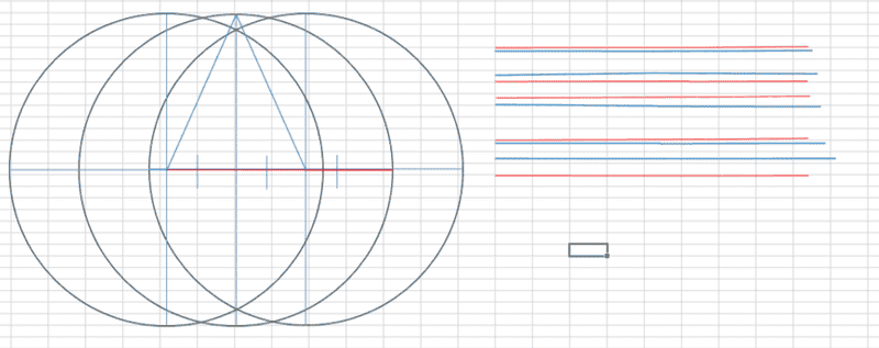

A few weeks ago, I thought to myself, Myself, can one measure the path the light beams on the Michelson Morley inferometer?
I played on Google and found some beautiful mathematical equations that could actually show the expected difference in length if a light beam when split and sent in opposing directions as what MM at first anticipated.
Then I thought, what if I follow the paths and measure the length and time and see if I can get a difference that might explain why MM did not find the fringe interference.
Now, it is a fact that I am not a scientist, but I would like to know what you guys think about my calculations.
The simple way math of coarse.
Michelson Morley's contraption allowed a 11 m path for the light to travel.
I decided to make it 12 m for ease.
This will give us a pathway for Beam A to travel 3m up to the beam splitter, 3m Left to the mirror, 3m right to the beam splitter again, and 3 m right to get to the end.
Beam B will travel 3 M Up, and 3 m up, and 3m down, and 3m right.
Therefore, if there is no (theoretical) movement on the contraption, the beams A and B will travel 12m each.

But looking at the problem we have on beam B when it reached the top of the path, and had to return back to the splitter to deflect it to the end, I decided to increase Michelson Morley's contraption to one c.
We made it 300 000 (theoretical c for this purpose)Km wide.
This made it work much better.
Beam A traveled
Up 1.00113333333 Sec 300 340 000.00 m
Horizontal 1.00000064222 Sec 300 000 192.67 m
Total 4.00113526000 Sec 1 200 340 578.00 m

In problems of this sort, it's a good idea to do the algebra first to get the general formula (in this case, the travel times and distances for the two paths as functions of ##D## (the arm length), ##v## (the hypothetical speed through the ether) and ##c##. You can check that for reasonableness (for example, does your formula show the travel time increasing with ##D##?) and dimensional consistency, and only after you're sure you have the formula right should you plug in numbers to get a quantitative result.
Google for "Michelson Morley calculations" and you'll find several good examples of this problem being worked. Bear in mind that an interferometer will easily detect differences that are a fraction of a single wavelength, and you'll find that the MM experiment is quite sensitive enough to justify the claim of a negative result.

Nugatory said:
(for example, does your formula show the travel time increasing with DDD?)
What I did was to take the distance to the left and right, squared it, and added it to the distance of movement ahead, squared, and with square root came to the distance the beam supposedly had to travel to get to the reflecting mirror, and back to the splitter, and then to the end.
a normal Pythagoras calculation.
Am I correct in my assumption?
That's the right general approach.
If you work through the algebra instead of plugging in the numbers from the start you will find that the difference in the length of the two paths is approximately ##Dv^2/c^2##. With ##D## equal to 11 meters and ##v## set to the orbital speed of the Earth that works out to about 100 nanometers, easily detectable by an interferometer working with visible light. https://hepweb.ucsd.edu/ph110b/110b_notes/node40.html is a pretty good explanation.

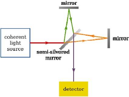

I see the assumption in this experimental measurement is to only measure from the splitter mirror to the reflecting mirror and back.
There is no measurements for
1. the light source to the splitter,
2. and a measurement from the splitter mirror to the telescope.
This simplifies the measurements a great deal.
Am I correct?
(Sorry, I will be a pesky itch until I feel I mastered the Lorenz transformation, and the MM experiment is the foundation to it all.)
Yes, because those are the only distances that affect the difference between the lengths of the two paths.
The Lorentz transforms folllow from the invariance of the speed of light. The MM experiment is just one of many that demonstrate that invariance. For more, you can try section 3 of http://www.edu-observatory.org/physics-faq/Relativity/SR/experiments.html (which is also linked in a sticky post at the top of this forum).

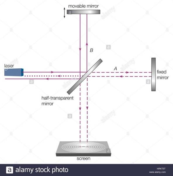

I spent some of my private time and went through the calculations on the expected Aether difference MM thought they would be able to measure, between a light beam traveling parallel to supposed Aether, and again a light beam traveling perpendicular to the Aether.
Now, there are a few thoughts I would like to clarify before I can continue.
1. the beam traveling parallel will take longer to return, than the beam traveling perpendicular to the Aether.
----this means the beam traveling perpendicular to the aether, was expected to arrive back on position first. followed by the one in parallel to the aether.
2. the difference is canceled out due to the length that contracts as the Michelson Morley inferometer travels against the aether, thereby squeezing the length of the parallel distance into itself equal to the difference between the beam traveling lengths. This difference is the calculation factor of Lorenz.
3. Due to this Length contraction, a clock that travels parallel with this light beam against the supposed Aether wind, will also run slower. otherwise we will measure the distance to be shorter that the time traveled. Time should also be adjusted accordingly.
It took me a while to summarize it this way.
If I am wrong, please tell me where.
Yes

P J Strydom said:
he way I see it is that the light will travel slower towards the reflecting mirror as it has to work against the Aether, but the return stroke will be quicker and will actually cancel this delay out.
If you want to drive from Chicago to Des Moines (call it 300 miles) at speed of 30 miles per hour for half the trip and 60 miles an hour for the other half, what is your average speed for the entire trip?
[Or to phrase it differently: "trust the math, not your intuition"]
