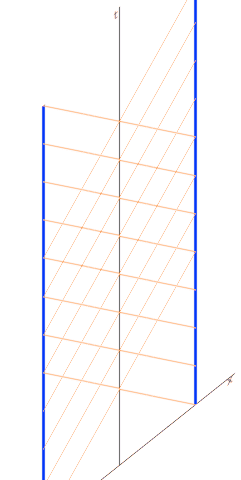

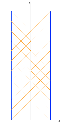

Here's a Minkowski diagram of the experiment. As usual, time is up the page and x position across; the blue lines represent the worldlines of the reflectors and orange lines the worldlines of successive wavecrests of the left- and right-moving waves.
You can see that wavecrests meet simultaneously (meaning that antinodes reach their maximum amplitude simultaneously) since their crossings form horizontal lines. You can see that the maxima happen in the same places because they also form vertical lines.
Now let's switch to an anisotropic light speed convention. All this does is shear the diagram:
I'm afraid my Minkowski diagram software isn't set up to do this so it's simply the original diagram sheared in an art package. In particular, please note that simultaneity in this revised diagram is still represented by horizontal lines - the sloped (and therefore non-simultaneous) x-axis is how this coordinate system draws the original frame's x axis.
You can see that the wavecrests no longer meet simultaneously since the crossing points do not form horizontal lines. They still form vertical lines, though, so the crossing points do not move. (Note that I was wrong to say that the timings of the amplitude maxima flow at the speed of the faster speed of light - they flow much faster than that, at the implied speed of the x-axis of the original frame. You can figure out what that is in terms of your faster and slower light speeds if you want.)

Do you mean an "anisotropic synchronization convention"? If so, then the 2nd diagram is, however, not a Minkowski diagram anymore.
Indeed. It's related to a Minkowski diagram by a shear, or the coordinate transform ##t=t_i-\alpha x_i## where ##t_i,x_i## are the usual inertial frame coordinates and ##\alpha## is a constant with dimensions of inverse velocity and ##|\alpha|<c^{-1}##.
dom_quixote said:
Unfortunately, I was unable to interpret the Minkowsky diagram, performed with reflecting mirrors.
Get a piece of paper and hold it on your screen with its edge parallel to the x axis of the graph. What you see at the edge of the paper is the cavity at one time. Slide the paper upwards to see time advance - you will see one set of lines moving left (representing the left-moving wave crests) and one set of lines moving right (the right-moving wave crests). Occasionally you will see the crests moving in opposite directions crossing - this is a maximum of the resultant standing wave. Note that several crossings will disappear beneath your sheet of paper at the same time - these maxima happen at the same time. You will see two sets of crossings, because every other half wave is out of phase with the previous one. But the location of a set is always the same - they don't move because this is a standing wave.
Now repeat the process on the second diagram, keeping the paper edge horizontally across the screen. Note that the left-going and right-going lines move across your paper edge at different speeds as you move it - light speed is anisotropic in this coordinate system. You'll find that the crossings no longer happen at the same time, but they still always happen in the same places. So you still have a standing wave.
