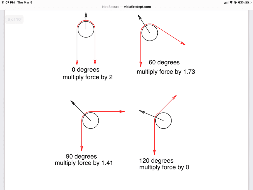

I believe that this will be the limit to the effective MA of P6:
When the angle of the ropes running through a pulley are at 0 degrees, the force will be doubled.
When the angle of the running lines is not 0 degrees, the effectiveness of the pulleys is diminished.
When the angle of the running lines reaches 120 degrees, there is no more mechanical advantage in that pulley.
Look for "120-degree rule" here:
https://www.frostburg.edu/faculty/r...s_preppers_chapters/Ch15-PulleySystems_v2.pdf
Yes closer to lifting limit height the MA will completely disappear. But once it’s raised and off ground all I have to do is stop pulling it up when it gets heavier

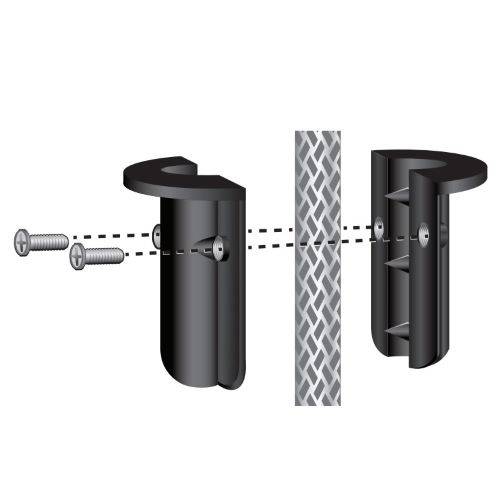

When I first read the OP, I believed that a roller hook and a truss between the poles will do the trick, bit resisting the bending of +100 pounds between 15 feet requires something robust.
Now I believe that a strong rope anchored to top of both poles will not stretch/bend much.
A pulley-hook that is free to roll sideways over that horizontal rope, will self-center between both poles when load is applied.
You could limit that lateral translation with some sort of adjustable collars, in such a way that the rig does not slap either pole under high wind conditions.
Because of that, the diameter of the rigging rope, which tension will be up to @30 pounds (considering friction and MA=4) could be much smaller.

Sorry, I should have said rope stop instead.
Just something that clamps the heavy horizontal rope, giving the hanger pulley some room to self-adjust, but not so much that the ropes and pulleys could hit the poles.
