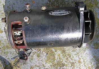

All US automobiles prior to about 1959 used a self excited DC generator (Europeans called them dynamo) which required nothing but rotation to make 30 amps. No magnets just armature, field and brushes , with a clever electromechanical regulator for control. Unlike an alternator it'll bootstrap itself up and supply its own field with no external supply.
read up on the simple dynamo , if it seems to do what you asked
Peruse the junkyards for one of these:
I liked them because even with completely dead battery (or no battery) you could push-start the car.
Chrysler went to alternators in 1959, Ford ~1964.

and that '51 Studebaker generator pictured makes its own 2 amps of field current, delivering up to 30 amps for the vehicle .
Reason they went to alternators is they are cheaper to manufacture (no big copper commutator) and alternator makes more current at idle speed - which was becoming an issue in stop & go traffic..
