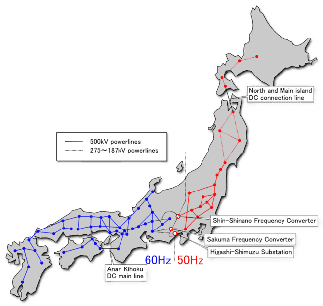

Japan is a mixed 50Hz/60Hz country.
https://en.wikipedia.org/wiki/Shin-Shinano_Frequency_Converter
