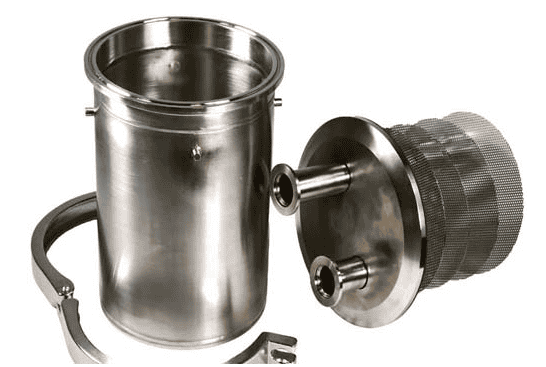

Hello! Perhaps a vacuum pump should be used together with a pre-vacuum filter? It is a device designed to capture or absorb oil vapor molecules coming from the pump inlet. In addition, it seems to me it makes sense to check whether the diffusion pump is the source of the oil.
An example of a pre-vacuum filter.
Pre-vacuum traps are used to protect against the reverse flow of oil from the pump to the working volumes.
They are used in combination with a mechanical pre-vacuum pump that works with a diffusion pump.

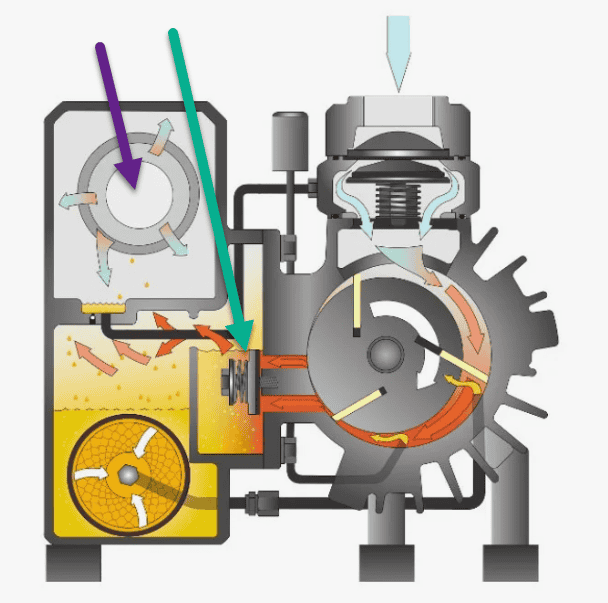

I suggest you check the valve indicated by the green arrow. If it does not work properly, the working chamber of the pump may overflow with oil, which will be intensively discharged through the inlet pipe of the pump. I also suggest you check the oil separator indicated by the purple arrow. If it does not pass air well, excessive pressure may be created inside the oil chamber, which will eject oil through the inlet pipe.
