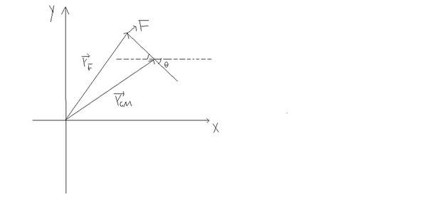

Yesterday my friend asked me: what will happen if a force F with constant magnitude is applied to one end of a free stick(no other force), and this force F is always normal to the stick.
He told me it's not a textbook problem and he just asked out of curiosity,so I decide not to put this thread in homework section, but still I'll show my attempt to the solution.
Suppose the stick is uniform with length l and mass M
Let's denote the position of center of mass as
[tex]\[\overrightarrow {{r_{cm}}} = (x,y)\][/tex]
The angle rotates over is [tex]\[\theta \][/tex]
then the point that the force applied at is
[tex]\[\overrightarrow {{r_F}} = (x - \frac{l}{2}\cos \theta ,y + \frac{l}{2}\sin \theta )\][/tex]
I choose the axis of rotation to be the axis perpendicular to the paper and passing thru the origin,and we know force is
[tex]\[\overrightarrow F = (F\sin \theta ,F\cos \theta )\][/tex]
then I can express torque as
[tex]\[\overrightarrow \tau = \overrightarrow {{r_F}} \times \overrightarrow F = F(x\cos \theta - y\sin \theta - \frac{l}{2})\hat k\][/tex]
About the moment of inertia I apply the parallel axis theorem
[tex]\[I = {I_{cm}} + M{D^2} = \frac{1}{{12}}M{l^2} + M({x^2} + {y^2})\][/tex]
Now we can just apply Newton's law:
[tex]\[\left\{ \begin{array}{l}<br /> \ddot x = \frac{F}{M}\sin \theta \\ <br /> \ddot y = \frac{F}{M}\cos \theta \\ <br /> \ddot \theta = \frac{{|\overrightarrow \tau |}}{I} = \frac{F}{M}\frac{{x\cos \theta - y\sin \theta - \frac{l}{2}}}{{\frac{{{l^2}}}{{12}} + {x^2} + {y^2}}} \\ <br /> \end{array} \right.\][/tex]
Then I'm totally stuck, I'm not that optimistic to expect an exact solution but the embarrassing thing is I can't even reduce the system to a single variable diff equation.
Can anybody help me reduce this? Any help is appreciated. Of course if somebody tells me there's an exact solution, I‘ll be happy enough to have a party.
(I checked these equations one time and hopefully no mistake. )

In general, trying to solve any mechanical system of ODEs, first try to find the integrals of motion of the system (if there are any), i.e. the conserved quantities (energy, generalised momenta). This often reduces the 2.nd order ODEs to 1.st order ODEs.
You have made a good choice of origin, except for the discription of the rotation. Hence, I think there's a mistake in the third equation of your system:
Here are some well-known identities:
[tex]L=J\dot\theta[/tex]
[tex]\dot L=M[/tex]
[tex]M=F\frac{l}{2}[/tex]
we do not need them in vector notation since the constant force is always normal to the stick (J is the moment of inertia, M is the torque and L the angular momentum)
You have to always be careful with the choice of frame of reference. Observe that the torque equals the time derivative of the entire angular momentum. As your calculations are absolutely correct, it follows:
[tex]M=\dot L=\frac{d}{dt}(J\dot\theta)=\dot J\dot\theta+J\ddot\theta=\frac{d}{dt}(\frac{1}{12}ml^2+m(x(t)+y(t)))\dot\theta+J\ddot\theta\neq J\ddot\theta[/tex]
so the 3rd. equation does not hold any more.
I would suggest to choose the axis of rotation in the centre of mass, so that you obtain a simple equation for theta (you won't need the parallel axis thm. )
Yes, that's really a big mistake. Thanks for the corection
Well, then that would be a non-inertial frame, I've thought about this, but I finally couldn't figure out how to apply a pseudo force on it so I gave up the attempt .
Marin said:
If you're familiar with Lagrangian and Hamiltonian mechanics I'd suggest to try from the beginning once again, as the concept there is much more profound and easier applicable. (you could use phi, theta and r as independent generalised coordinates, since you have 2-dimensional translation and 1-dimensional rotation). In this case you could also admit gravitational field or any other non-dissipative force and still obtain the correct equations of motion. Furthermore, the integrals of motion are directly to read out of the Lagrangian.
I will learn these stuff this semester and I'll try the method later.
Anyway the equation still seems to be coupled, so I guess it can't even be uncoupled? And let's generalised the question, how can I know if the equation can't be uncoupled?By failing infinitely many times?

[tex]M = F(x\cos\theta-y\sin\theta-l/2)=F(m/Fx\ddot y-m/Fy\ddot x-l/2)=m(x\ddot y+\dot x\dot y-\dot y\dot x-y\ddot x)=m\frac{d}{dt}(x\dot y-y\dot x)[/tex]
Well, maybe I'm just too new to ODE stuff, I really appreciate this graceful step.Seems that you constructed a derivetive of a Wronskian, it just never occurred to me before. But you probably missed the l/2 term.
yes, that's correct. I did miss the l/2 term ;)
As to the Wronskain, it was't meant that way, but if there's such a method it's fine. What I tried to do is to add and subtract certain term, so that the derivative becomes explicit. By doing so sometimes one approaches a direct integration of the equation (but this didn't entirely happen here).
