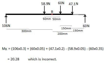

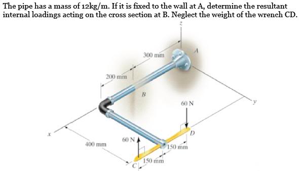

Hi everyone. I am attempting to calculate the internal moment at point B about the y-axis. I have correctly found everything else.
My calculations:
Weight of 500mm section of pipe = 58.9N
Weight of 400mm section of pipe = 47.1N
Vertical reaction at A = 58.9 + 47.1 = 106N
Moment = Force x Distance
I'm not really sure I can do that with the two 60N forces, but I also can't see why not.
The correct answer is 6.23Nm according to the solutions provided.
Any help would be greatly appreciated!
Matt
For the portion of the tube along the X axis due to the tube weight
Moment at B = (1/2)*g*12*(0.2)^2 = 2.35 Nm
For the downward 60N force
Moment at B = 0.05*60 = 3.0 Nm
For the rod portion along the Y axis
Moment at B = 0.2*0.4*g*12 = 9.41 Nm
For the upward 60N force
Moment at B = -0.35*60 = -21 Nm
Total moment at B = 2.35+3.0+9.41-21 = -6.24 Nm, where -ve sign CCW direction
