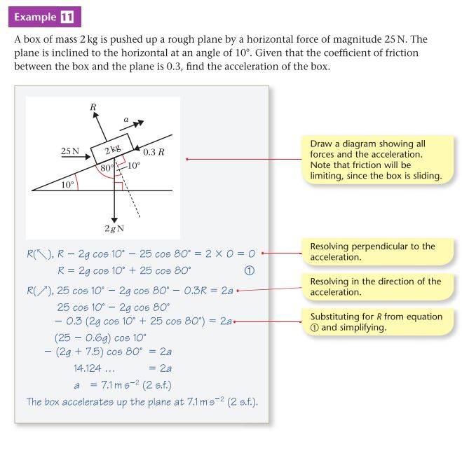

Find acceleration of the box
coefficient of friction and
I'm okay with the concept of resolving into two components.
BUT, with re: to resolving perpendicular to the acceleration, I don't understand how 25cos80 comes into?
Surely it should be included when I'm resolving in the direction of the acceleration?

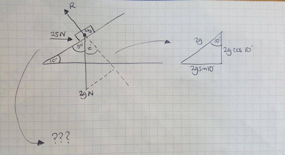

Thanks for your help so far but tbh I'm still lost.
Here's what I've done so far:
So I've resolved the first part into 2gsin10 and 2gcos10 but after looking at the problem for the past hour I still can't see how I can break down the 25N into two components.
Draw a similar triangle for that 25N force. The force acts horizontally: you want its components perpendicular and parallel to the incline. What angle does the force make with the incline?
Likes trew

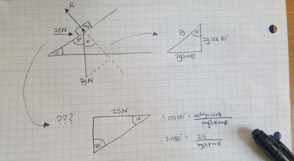

Ok so I did that and this is what I got:
so I can't see how I would still get 25cos10 for the hypotenuse side? Or have I done this triangle wrong?
Yes, the triangle is wrong. The 25N force must be the hypotenuse of the right triangle. (The components will be the shorter sides.)

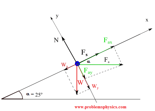

Nothing wrong with using a right triangle to find the components. Here's a diagram for a similar problem (that I found on the web). Perhaps it might inspire you:
240982
In that diagram, the applied force Fa is horizontal just like in your problem. (See if you can find the correct right triangle.)

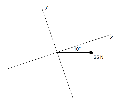

Nonetheless, as long as the angle Θ is with respect to some axis (whatever that is in your problem), then FcosΘ will be the component parallel to that axis.
Can you find the x and y components of the 25 N force?
