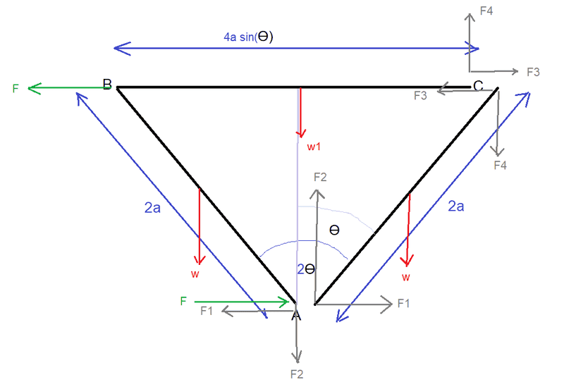

Please could I ask with help with the following question:
I have done part (a) and agree with the answer given in the book of 2a (2w + w1) sin(Ө)
It is part (b) where I am stuck. Here is my diagram:
(In green are show the forces of the couple - but they are not needed in my following working)
In grey, I have labelled the internal forces F1, F2, F3 and F4 on the system when considered as being made up of the two parts ABC and AC.
I need to find F3, F4, F1 and F2.
I have these four answers from the book, they are:
(1/2)*(w + w1) tan(Ө)
(1/2)*w1
(1/2)*(2w + w1)
Considering rod AC only and resolving horizontally I have:
F3 = F1
and resolving vertically I have:
F2 = F4 + w
These equations are consistent with the given answers.
Still considering only rod AC, taking moments about A leads to:
2*F3 = w *tan(Ө) + 2 * F4 * tan(Ө)
(again, this is satisfied by the given answers)
And taking moments about C leads to:
2*F1 + w * tan(Ө) = 2 * F2 * tan(Ө)
So I have these four equations, which the required answers satisfy, but I can't see how to determine the values of F1, F2, F3 or F4 from these. I need another equation.
I thought to consider the part ABC and resolve vertically, but this leads to:
F4 = w + w1 + F2
Which is NOT satisfied by the required answers.
How can I proceed? (Have I labelled the internal forces with the correct directions?).
Thank for any help,
Mitch.
F4 = w + w1 + F2
There is an external force acting on this part of the system which you have not included.
Thanks for your reply,
It is not the couple forces (F) as I am resolving vertically, and they both act horizontally.
Ahh, would it be the force at the pivot B?
If so then I don't want to introduce this unknown into my equations. So I could consider ACB and take moments about B. This would lead to:
F4 * 4a *sin(Ө) + F * 2a * cos(Ө) = F1 * 2a * cos(Ө) + F2 * 2a * sin(Ө) + wa * sin(Ө)
(Call this "equation1")
But of course now I have F involved.
Can I use the result from the first part of the question to say the the moment of F about B is:
2a (2w + w1) sin(Ө) ?
So that would give:
F * 2a * cos(Ө) = 4aw * sin(Ө) + 2a * w1 * sin(Ө)
I would then substitute this into "equation 1" to give a new equation relating F1, F4 and F2.
From this I could substitute in from my earlier equations for F1 and F4 both in terms of F2 and so solve for F2.
Would that be the way to go, or is it wrong to use the answer to the first part of the question in this way? Or indeed, if it is ok, then it there a simpler approach?

Unfortunately, this approach hasn't worked.
So, if I consider part ABC and take moments about B (so as to exclude the reaction force on the pivot at B) I get:
F4 * 4a * sin(Ө) + F * 2a * cos(Ө) = F1 * 2a * cos(Ө) + F2 * 2a * sin(Ө) + w*a*sin(Ө) + w1 * 2a * sin(Ө)
which simplifies to:
4*F4*tan(Ө) + 2F = 2*F1 + 2 * F2 * tan(Ө) + w * tan(Ө) + 2 * w1 * tan(Ө)
(Call this "equation 2")
Now, from part (a) I know that:
F * 2a * cos(Ө) = 4*a*w*sin(Ө) + 2 * a * w1 * sin(Ө)
this simplifies to:
2F = 4*w*tan(Ө) + 2 * w1 * tan(Ө)
and I also know from my earlier working when considering AC only that:
F4 = F2 - W
and
2*F1 = 2 * F2 * tan(Ө) - w * tan(Ө)
So I can substitute for F, F4 and F1 into "equation 2"
and when I do this, everything cancels leading to 1 = 1.
Can anyone see where I have gone wrong?
Thanks.

Note that the question depends on the fact that all joints are freely hinged. If B were fixed the set up would be statically indeterminate.
So you need to consider the balance on e.g. AB.
I see, yes, all joints are hinged. So I must consider a rigid part. ABC is not such a part. AB is.
If I take moments for AB about B I get:
2a*F*cos(Ө) = 2a * F1 * cos(Ө) + 2a*F2*sin(Ө) + wa * sin(Ө)
2F = 2 * F1 + 2* F2 * tan(Ө) + w * tan(Ө)
Now I substitute in for F and F1 as I did previously, and this gives:
4*w*tan(Ө) + 2 * w1 * tan(Ө) = 2 * F2 * tan(Ө) - w*tan(Ө) + 2*F2*tan(Ө) + w * tan(Ө)
and this gives:
F2 = 2w + (w1)/4
whereas I had hoped for F2 = w + (w1) / 2
Have I just made some stupid arithmetical error?
and this gives:
F2 = 2w + (w1)/4
OK, found it. Was indeed an arithmetical slip. Thanks so much for all of the help. My main lesson here has been to be mindful of which parts of the system are rigid. Thanks again, Mitch.
