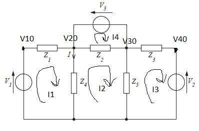

Hi Everyone.
Just a brief hello before the problem! I am a new user as of today. I am studying Electrical Engineering in my spare time after work, and currently working full time an electronics service engineer. I have tried to make the problem as clear as I can, any help would be highly appreciated.
The problem asks to produce a current via two methods. I have obtained two answers that are different and would like to know where I went wrong.
For the record, most of my calculations were done within matlab. This is also my first attempt at using matrices, so I am unsure if my calculations were correct (or whether it was necessary to use matrices in the first place).
Determine the current I by
A) Mesh Analysis
B) Nodal Analysis

[tex]I = I1-I2-I4[/tex]
[tex]I = 16.8112 - j22.8793 - 25.9629 - j40.1548 - 28.7914 - j42.9832[/tex]
[tex]I = -37.9431 + j60.2587 A[/tex]

As you can see I have very different answers, and have scratched my head all weekend over it.

For your mesh analysis everything looks good. Your matrix is fine, your resulting mesh currents are fine. However...
When it comes time to calculate ##I##, keep in mind that mesh currents are not branch currents. Your calculation seems to be assuming that they are branch currents and you're summing (KCL) them at your node V20. This is incorrect. Two mesh currents flow through Z4. Find ##I## from them...

[tex]I1-I4-(I2-I4) = -9.1517 + j17.2755[/tex]
which matches my node result.

I think you meant: simply ##I = i_1 - i_2##, since ##i_1## and ##i_2## are the mesh currents that flow in the branch where ##I## is indicated. ##i_4## doesn't enter the picture at all.

But, also note that sometimes the branch currents are the same as the mesh currents. For example, the current in branch Z1 is equal to the mesh current I1 (paying attention to the assumed direction of the currents); the current in branch Z3 is equal to the mesh current I3.
Loop analysis (as distinguished from mesh analysis) allows paths for virtual currents that may encompass several meshes. Often a loop can be chosen so that the virtual loop current is the same as a desired branch current. Had you chosen the current I2 to traverse a clockwise loop through Z1, Z2, Z5 then back along the bottom to V1 and closing at Z1 (encompassing both I1 and I2 meshes as shown o, then virtual current I1 would be equal to your desired current I, and you wouldn't have to add two mesh currents to get I.

Redo your A and B matrices using what you have just got, solve, and I1 should be equal to your required I. Give it a try; what do you get?
This works because now the only mesh current though Z4 is I1. I2 is now a loop current that doesn't pass through Z4.
This is not a mesh solution, however, it's a loop method solution.
