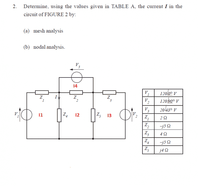

Please see a picture
KVL
V1-I1Z1-(I1-I2)Z4=0
Z2(I2-I4)+Z5(I2-I3)-(I2-I1)Z4=0
Z3I3+V2+Z5(I3-I2)=0
V3+Z2(I2-I4)=0
Any clues are appreciated..

When you write your mesh equations make sure to first indicate your assumed current directions, then make sure that you are consistent in summing either potential drops or potential rises. I note, for example, that last term in your second equation seems to be inconsistent. The first two terms look like potential drops due to assumed clockwise mesh currents, while the last term looks like a potential rise. Similarly for your last equation, the currents in the second term don't don't match the assumed mesh current directions if the V3 term is taken to be a potential drop for KVL going clockwise around the loop.

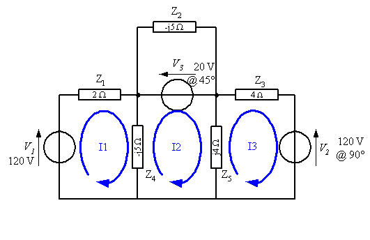

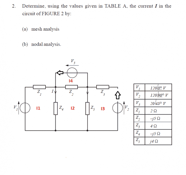

Attached direction of currents as suggested.
Mesh currents should be indicated by curved arrows inside the given loop, not in the wiring itself. Otherwise there can be confusion as to the direction on the shared boarders of loops -- which arrow pertains to which mesh?
Usually it's convenient to have all the mesh currents be either clockwise or counterclockwise (there's a good reason for this, having to do with a very simple way to write the mesh equations in matrix form by inspection which I'm sure you'll cover in your course at some point).
You seem to have chosen the following:
I1 : clockwise
I2 : clockwise
I3 : counterclockwise
I4 : counterclockwise
That's fine, but now you'll need to write out your mesh equations accordingly.

V1 -(Z1+Z4)J1+Z4J2 =0
Z4J1-(Z4+Z2+Z5)J2+Z5J3-V3=0
Z5I2-(Z5+Z3)I3-V2=0
Z5I2-(Z5+Z3)I3-V2=0
Okay, so you've decided that Z2 is irrelevant to the second loop since its potential difference is constrained by V3. That's a good observation! It reduces the number of loops that you have to deal with. However, it means that Z2 should not appear in the second term of your second equation above. Make that change and try solving the system for the mesh currents.

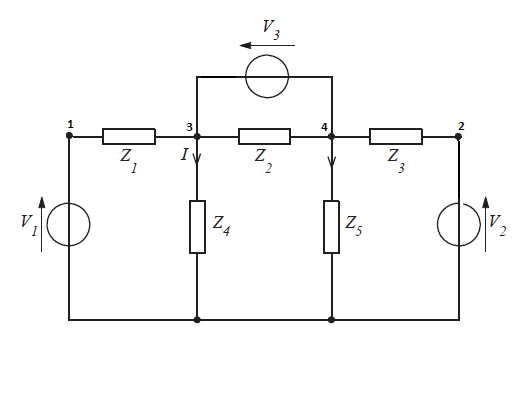

I'm not seeing how your equations pertain to the circuit. Perhaps it would help if you were to indicate on your circuit diagram the nodes. Remember that you need to identify a reference node ("ground") and the essential nodes. Hint: V3 makes life easier once again in a super way.

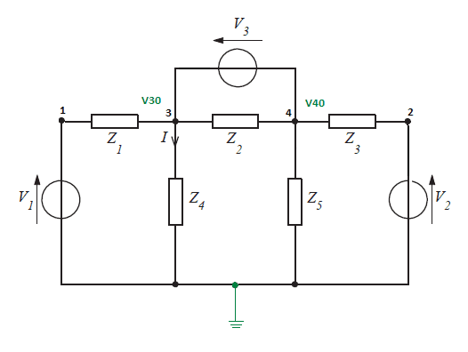

attached diagram
Your nodes 1 and 2 are not essential nodes --- they are embedded within series-connected branches wherein all components share the same current. So drop them from consideration.
That leaves nodes 3 and 4, both of which are where several branches supporting different currents connect. This identifies them as essential nodes. You did not identify your reference node, but I am going to assume that you've selected the bottom node for that purpose, correct?
Now, go back to the hint I left you with last time. What can you say about the relationship between the potentials at nodes 3 and 4?

V30-V1/Z1 + V30-V40/Z2+V30/Z4+V40-V30/Z2+V40-V2/Z3+V40/Z5 =0
V40=V30+V3
V40=V30+V3
Getting closer. However...
V3 forces a fixed potential difference between V30 and V40. This creates a special situation. Note that the voltage source V3 has no impedance associated with it, so you cannot treat it like another branch and write a current for it via Ohm's Law. Yet it connects V30 and V40, and must influence KCL at those nodes.
This is a case where you consider that the fixed relationship between those nodes imposed by that fixed voltage source creates what is called a supernode. A supernode is made up of a set of nodes with potential differences that are fixed by voltage sources connected between them.
Check your text, notes, or web for the supernode concept. See if you can't identify the supernode on your circuit diagram and draw a boundary around it. When you write the node equation for a supernode you consider only the currents entering or leaving the supernode as a whole (passing through the boundary, as it were). Currents internal to the node are ignored, and only the fixed potential differences have an impact (setting the potentials at the wires protruding from the supernode).
