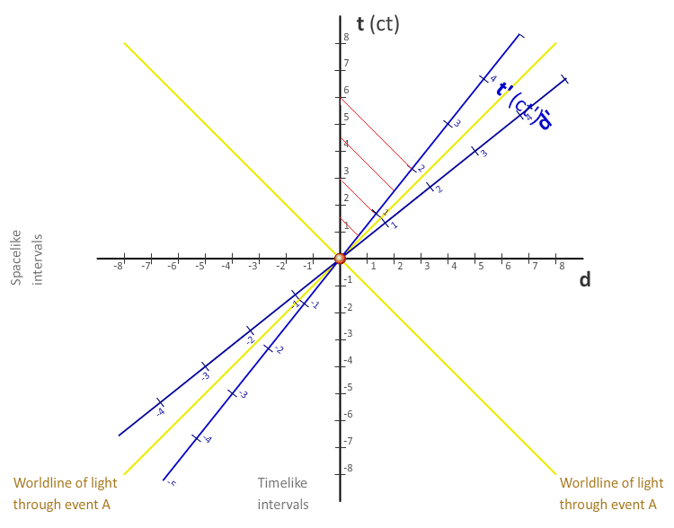

Suppose we have a spacetime diagram like this:
Red lines indicating light travel from the moving object to the observer.
Object is moving at the speed of 0.8c. At this speed we have:
Lorentz factor 1/√(1 - v2/c2)=1/0.6=1.66(6)
Relativistic Doppler effect √((1 + β) / (1 - β)) = 3
My question is what does the observer see?
According to this diagram At time t=3 (let's say year) observer sees object 1 year old. At t=6, 2 years old. 6/2=3 and we get Doppler effect.
As far as i know moving at 0.8c speed in no matter what direction relative to the observer results in time ticking at the speed 0.6 (or 1.66(6) slower).
Suppose at t=6 (t'=2) object starts to move towards the observer (same speed).
At t=6, object should arrive to the observer, and be 3.6 years old.
But how's that possible?
How could it be that observer sees the object at time t=6 at both places: arrived, and just starting to making a turn?
I don't understand.
If the object makes a turn at its Proper Time of 2 years, why shouldn't the observer see that at his Proper Time of 6 years? What is the problem?
Yes, object makes a turn at his proper time of two years. But the observer sees an object both: 1) making a turn and 2) arrived at destination at t=6 years.
The observer's Coordinate (and Proper) Time is 6 years and his Coordinate Location is 0 light-years. The object's Proper Time is 2 years but in the unprimed frame, its Coordinate Time is 3 1/3 years (not 6 years) and its Coordinate Location is 2 2/3 light-years. Read the coordinates off the graph.

The observer cannot see the Coordinate Location unless someone has put up signposts or other landmarks to tell him the location and he cannot see the Coordinate Time unless someone has put a clock synchronized to the Coordinate Time at that location. We don't normally think of the Coordinates as being marked off with clocks and location markings but you could certainly do that if you want.
However, the observer can use radar measurements to determine how far away the object was at any particular time and those will match the Coordinates in his rest frame, but you didn't show him doing that.
Also, if the object was actually another observer, he could be making all the same observations and measurements of the first observer (except, of course, if he has turned around at his Proper Time of 2 years, things will look different, I'm talking about if he continued on in a straight line).

It's not hard. D(t), or to be consistent with your drawing, d(t) = vt = 0.8t. But since you drew the line according to that function, you must have already been aware of it, correct?

I see you changed your question while I answered your previous version.
We can observe the Coordinates on a graph and the observers in the scenario can too if they know ahead of time what will happen (and everyone sticks to the plan) but they cannot see the Coordinate Locations and Times as they are happening. But as I said before, they can use radar to measure what happened (without knowing ahead of time what was going to happen) and then they can construct the graph later on.
Thank you. So at time t=6 we see an object v*t=0.8*6 = 4.6 ly away. Is this consistent with statement that it takes some time for light to travel the distance? What about observed time?
If D observed is v*t, I guess t' observed is t'(t)=t/lorentz factor? Correct? Oh and should't D observed be also divided by lorentz factor?

More like 4.8 ly away and it is consistent with the observer at rest sending a radar signal at his Proper Time of 1.2 years and receiving the echo at 10.8 years and the observer assuming that the signals traveled at c going and coming and calculating that at the midpoint between those two times the signal reflected off the target and was 1/2 the difference in those two times as a distance in light-years away. That's the radar measurement I was talking about.

The observer doesn't necessarily know that the speed is v, he can use successive radar measurements to calculate the speed based on the assumption that the signals travel a c with respect to himself. He doesn't have to know about the Lorentz factor, he just looks at the time on the object's clock compared to the time he calculated based on his radar measurements. It will turn out that all his measurements correspond to what we would calculate with the Lorentz Transformation process. Also, there is no length contraction going on in this scenario. If you had a size for the object, then it would be length contracted and the observer could measure that also using radar.
Yes, 4.8. I'm wondering how you calculated 10.8 years. d(1.2) is 0.96 ly. Object is hit at time t 1.2 + 0.96/ (1 - 0.8) = 6 years.
But we don't see it yet, D(6) = 4.8, it takes 4.8 years for light to reach us. So we see a reflection at 4.8+6=10.8.

The Proper Time (the observer's time on his clock) is used to measure the time at which he shoots a photon and the time at which he receives the reflected photon. If we call the first one t_e and the second one t_r, then (using units where c=1):
D = (t_r - t_e)/2
and
T = (t_r + t_e)/2
where T is the time according to the observer's Proper Time that the distance, D, applies and these two coordinates are what he would plot on a diagram.
Assuming that the observer can see the Proper Time, t', on the target's clock at his own Proper Time at t_r, then T/t' = gamma. EDIT: This is assuming that the clocks were synchronized when they were colocated and that they remain inertial.

I was looking back over your original post and I see that you edited it after I responded to it. You added the comment that I have put in bold and now I can see what you were asking. Your drawing doesn't show the object turning around but if it did, you would have to show it coming back at 0.8c instead of 1.0c as it appears you were assuming. As such, it would not arrive back at its age of 3.6 years old but rather at 4.0 years old and it would not arrive back at t=6 but rather at t=6 2/3 years. So the observer does not see the object at time t=6 at both places. At t=6, he sees it turn around and during the course of the next 8 months, he sees it coming back to him and he sees it aging by 24 months during that time which is in agreement with the Relativistic Doppler factor of 3.
Hopefully, this all makes sense to you now.
