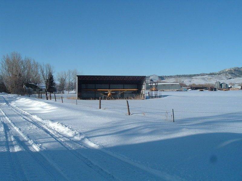

Here's a "not really good" picture of it taken on 2-27-2009... we sold it locally here, to a friend, on 9-10-2009...
