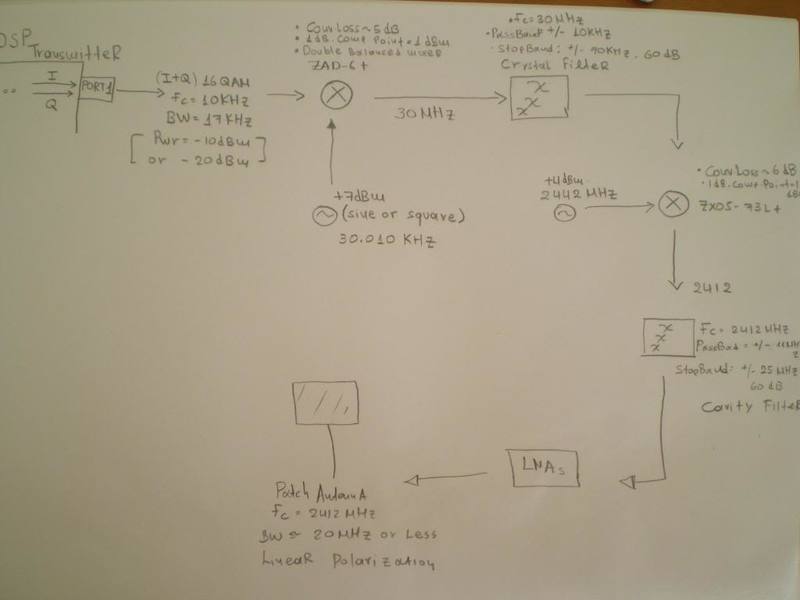

Hi ! I am making an RF Transmitter and i have a problem with power leakage for LO port to IF port and RF port. I don't know what to do and i am little confused about how can i fix this.
Source(-10 or -20dBm) 10KHz --------->MIxer conv.loss=8db--------->RF port
and
L.O=70MHz and 7dbm
I put an oscilloscope to mixers input IF and i don't see a sin wave from my Source. I is a sine wave with a lot of phase noice and amplitude variations..when i decrease the L.O power the sine becomes better.:o
I have heard about attenuators but i cannot understand how they will solve the problem. They attenuate maybe the standing waves that maybe create ?Also and my signal right?
I don't understand...
Can you post a schematic and some photos? What bands are you building this transmitter for?
[/URL]of course...here...i have some problem with the crystal filter there..but basically this is my transmitter...i think i will need attenuators sure before the mixers...
just a little note on circuit symbols...
are they supposed to be band pass filters ??
if so you need to learn to draw them correctly, the centre sine wave shouldn't have a strike through it ;)
as you have shown them they let nothing through low mid or hi
