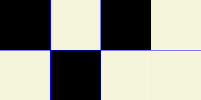

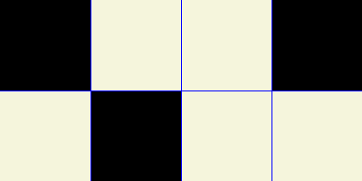

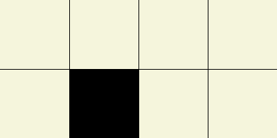

Adding 2 sources for ##g_{ij}## could be done pointwise as follows:
$$ g_{total} (r, \theta, \phi) = g_{ij} (r, \theta, \phi) + $$
$$g_{ij}(Sph_r(Cart_x(r,\theta,\phi)+dist_x, Cart_y(r,\theta,\phi)+dist_y, Cart_z(r,\theta,\phi)+dist_z))$$
Single source metric is a vacuum solution:
Two sources at cartesian distance 50,000 is a mess (the further the messier):
  • #40
Sorry the coordinate notation was abstract. Here's a real example, the point (1, 1, 1) in spherical coordinate is first transformed into cartesian via:
$$x = r \sin \theta \ cos \phi$$
$$y = r \sin \theta \ sin \phi$$
$$z = r \ cos \theta$$
we obtain the new cartesian coordinates:
Next we add some cartesian offset we like, eg. 10 to each coordinate:
Then we transform back into spherical coordinates via:
$$ r = \sqrt {x^2 + y^2 + z^2}$$
$$ \theta = \arccos \frac{z}{r}$$
$$ \phi = sign(y) \arccos \frac{x}{\sqrt{x^2 + y^2}}$$
we obtain the new spherical coordinates:
At each gridpoint, ##g_{ij}## is defined in terms of every ##\{r, \theta, \phi\}## values. By adding pointwise the ##g_{ij}## values for both (1,1,1) and (18.3, 0.95, 0.79) we sum as if two different sources of ##g## are located at 10 distance apart cartesian-ly.

Starting with ##T_{ij}## we have 16 numbers for each 3D gridpoint, with particular places we want to have all 0 values. The problem seems to be trying to reverse engineer what R and ##R_{ij}## will give rise to this result, then reverse engineer the ##\Gamma^i_{jk}## and all the way to ##g_{ij}## if necessary, to ensure this desired result?
Both R and the 16 ##R_{ij}## numbers must be zero at precisely these same locations we want ##T_{ij} = 0##. How about the 256 ##R^i_{jkl}## numbers, what algorithm will reconstruct these numbers so that the downstream results are as desired?
Generalizing to Kerr ##g_{ij}##, we switch to:
$$g_{ij} = \begin{bmatrix} (1 - \frac{2mr}{(r^2+a^2\cos^2\theta)^2})c^2 & 0 & 0 & \frac{2mcra\sin^2\theta}{(r^2+a^2\cos^2\theta)^2} \\ 0 & \frac{(r^2+a^2\cos^2\theta)^2}{r^2+a^2-2mr} & 0 & 0 \\ 0 & 0 & -(r^2+a^2\cos^2\theta)^2 & 0 \\ \frac{2mcra\sin^2\theta}{(r^2+a^2\cos^2\theta)^2)} & 0 & 0 & (r^2+a^2)\sin^2\theta + \frac{2mra^2\sin^4\theta}{(r^2+a^2\sin^2\theta)^2} \end{bmatrix}$$
When ##a=0##, this reduces to Schwarzchild ##g_{ij}##.
The metric for twin sources can be reasonably approximated using a single metric, when the separation distance is very small. The analytic version is called Kerr-rotator [here].
Kerr-Kerr ##T_{ij}## distance 0:
Kerr-Kerr ##T_{ij}## distance ##\pm 1##:
Kerr-Kerr ##T_{ij}## distance ##\pm 5##:
Kerr-Kerr ##T_{ij}## distance ##\pm 10##:
Kerr-Kerr ##T_{ij}## distance ##\pm 20##:
Kerr-Kerr ##T_{ij}## distance ##\pm 30##:
Kerr-Kerr ##T_{ij}## distance ##\pm 40##:
