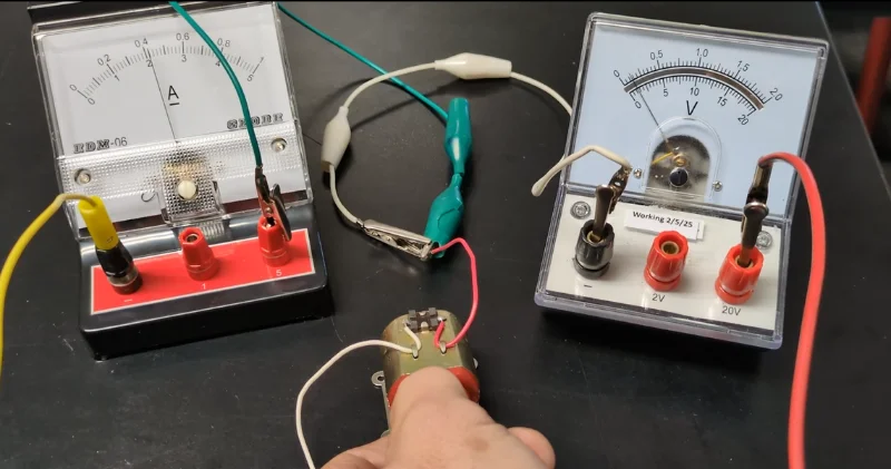

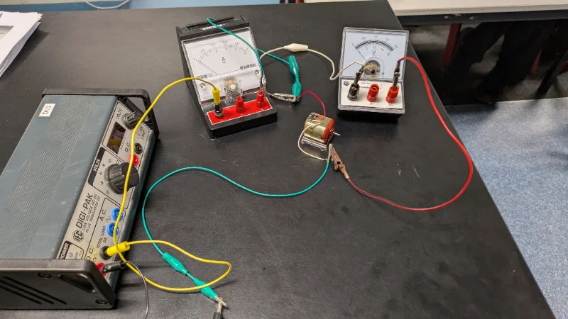

Hi there,
I have done an experiment measuring the voltage across the terminals of a dc motor, whilst running and then by holding it with my fingers to stop it. Done as demo for my high school class.
The voltage reading was higher when the motor was running, which was against my expectations as I thought the back-emf would have created a lower net voltage (being measured on the voltmeter on the motor terminals?).
So now I am guessing that the internal resistance of the motor is varying a
Hi there,
So now I am guessing that the internal resistance of the motor is varying a lot to create this result?
Many thanks
When you run a DC motor on a fixed voltage, it produces a back_EMF, proportional to speed. A DC current flows through the motor, providing power to overcome losses. That DC current drops a voltage across the motor internal resistance.
The supply voltage = back_EMF + resistive drop.
When you stop driving the motor with a fixed supply voltage, the back-EMF remains due to momentum, while the motor current becomes zero, so the resistive voltage drop disappears. That is the voltage step that you see when you disconnect the motor.

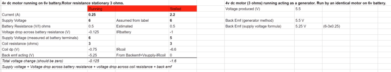

So how would I model (in a spreadsheet )the predicted net voltage across a small 4 V DC motor hooked up to a laboratory power pack set at 2V when the motor is slowed down to different % max speeds by finger resistance?
pkc111 said:
Thanks,
and would I be better off trying to quantify a motor's back emf with a battery rather than a transformer power supply?

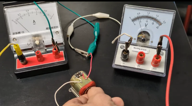

So my DC motor with a 6V battery attached gives a 5V PD reading across the motor terminals. When the rotor is held still with fingers it reads 3V...whyso? I thought the voltage would go up when held due to the absence of a back emf.
Also when I use the motor shaft to drive an identical motor shaft (to use it as a generator), the "generator" produces a 4V reading. I assume this is the same as the back emf value in the motor? But the numbers arent agreeing?

If you draw a schematic diagram of the circuit (if you don't know what I mean then hunt around for a web page about motor back emf) you can copy that and get used to circuit diagrams as second nature. There will be a battery emf, a battery internal resistance (r), a motor winding (with a back emf) and a motor resistance (R). All in series. And then add the meter readings. i.e. present yourself with the problem in a way that will help you. (Like you get in problem exercises)
The voltage drops all round the circuit when the motor is stalled can only be caused by the two series resistances. If you are measuring an unexpected value of voltage drop then you must have an unexpected value of effective resistance somewhere. Will your meter measure the motor stall current?
Do you have any handy low value resistors (anything between 1 and 10 Ohms) and see if your estimated battery internal resistance makes sense.
PS That table could have been much more use if you'd used higher definition and checked legibility before posting. It may only need a change of (scanner?) settings, somewhere.
