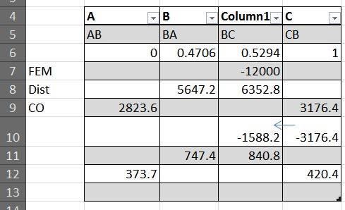

Well , i ended up getting this one ... I found that my moment about A is no longer 2823.6... I just did it halfway , for line 10 , the moment -3176.4 is carried over to BC become -1588.2 (This is similar in the first example , where the moment CB is carried over to BC )
If it's wrong , why can't i do in this way ?

why there's no need to carry over the moment from CB (-3176.4) to BC become -1588.2 ??

I forgot that when we have a pin end (So pin C), the moment distribution method can be simplified by the following two steps:
1. Stiffness factor is taken to be K = 3 EI/L
2. Carry over factor to that member is 0 , not 1/2
And when you do so and try to continue iterating you will find that all your new Dist and CO moments are 0.

why in example in 607.jpg , the moment carried over from BC to CB or vice versa is half ? Can you explain the differences for both cases?
In figure 607, the author solved the example without using the simplifications mentioned in post #15, he used a stiffness factor of 4 EI/L for member CB and when you use that stiffness value, you must use a carry over factor of 1/2. So the exercise took longer to solve.
We already know that for far end pinned / roller supported , the Stiffness factor is taken to be K = 3 EI/L , why the author use K = 4 EI/L in 607.jpg and use carry over factor of 0.5 ?
Is it wrong to do so ?
The formula K = 4 EI/ L is derived from a beam that is assumed to be pin at one end and fixed at the other (pg : 509 of the textbook your using), and with this assumption, the carry over factor is calculated to be 1/2.
When we use K=4 EI/ L for the pin end support as the author did , we are basically assuming it to be fixed (when in reality it is not) AND after iterating through the long process we see that the actual moment at the assumed fixed member (which is an actual pin) is 0. So what does that mean? Well if M=0, then we only have internal axial and shear forces which are reminiscent to a pin/roller support which is the true configuration of the given problem. So, everything works out in the end.
So, it is not wrong to do so. You will get the same answer if you use K= 4 EI/L AND CO=1/2 or K=3 EI/L AND CO = 0 for the far pinned end.
