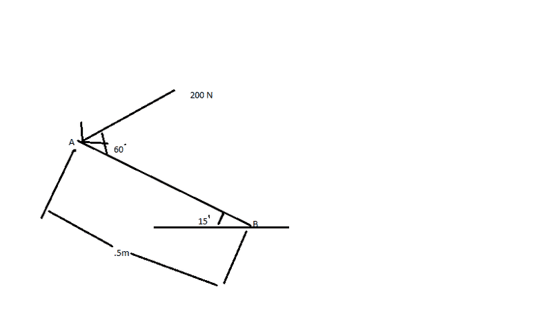

Could someone take a look at what I am working on and tell me if I am on the right track?
#1: Determine the moment of the 200 N force about point B. Please see attached picture for FBD.
First I find the x and y components.
x = 100N y= 173.2N, which are perpendicular and parallel to AB.
Then I find the distance of the 15° angle.
sin15(.5) = 0.13m
cos15(.5) = 0.48
So, now I add the forces to determine the moment about point B.
Mβ = +(173.2)(.48) - (100)(.13) = 70.1 N.M c.c.w
It would be of great appreciation is someone could help me.
Thank you.

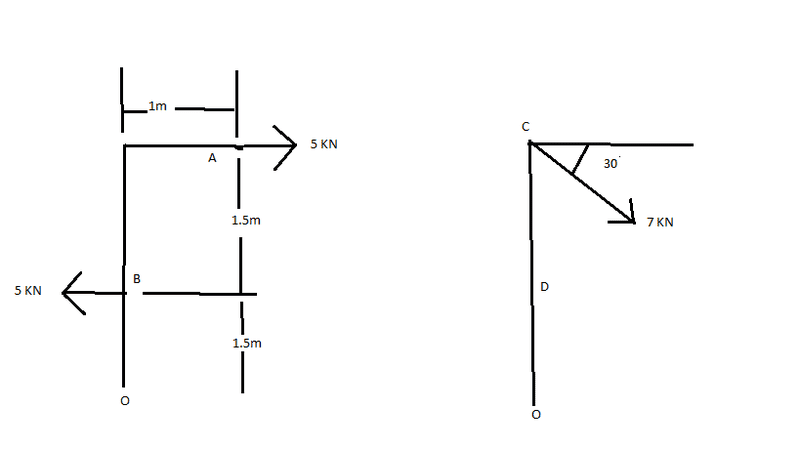

2: Says, replace the two 5 KN forces with an equivalent system consisting of the 7 KN force applied at C and a second force applied at point D. Determine the magnitude and direction of the second force and the distance CD.
Please see the picture for the FBD.
How I did this.
First I found the moment about point O for the two 5 KN forces.
Mo = -(5KN)(3m) + (5KN)(1.5m) = -7.5 KN.M c.w
Then I found the x and y components for the 7 KN force.
7(cos30) = 6.06 KN 7(sin30) = 3.5KN
Next I placed the 6.06 KN and 3.5KN force at point D and solve the moment about point C,( Cancelling those forces) and rearranging for the distance CD.
Mc = (3.5)(0) - (6.06)(d) = -7.5 KN.M
d = -7.5 - (3.5)(0) / -6.06 = 1.24 m
So, Magnitude = 6.06KN c.w. and CD = 1.24m
