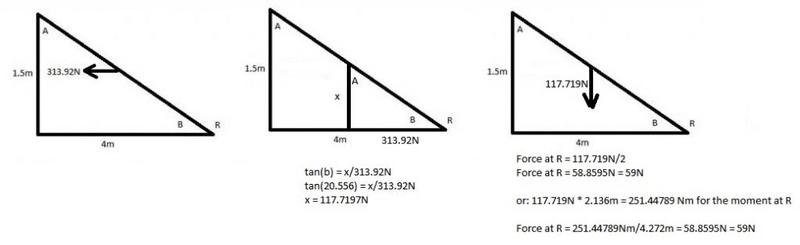

Moment = force * perpendicular distance

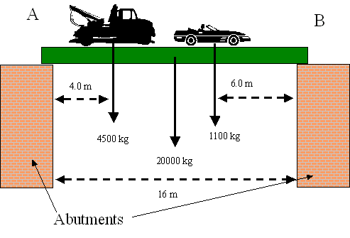

My book says the answer is 59N, I don't get why my method failed, I use the exact same thing for problems such as calculating the contact force produced by the ground at the end of a bridge and I've never had any problems.[/B]
Note that R is not perpendicular to the ladder.
When I do these kinds of problems usually the beam/ladder are always perpendicular to the pivot/r making it hard to work out how these things work.
Ok, does this mean that the force always needs to be perpendicular to the pivot even if it results in the force not being perpendicular to the beam/ladder?

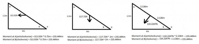

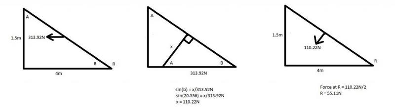

I think I finally understand this, can you confirm?
I thought the arrow of force had to be perpendicular to the pivot, but it seems this is not the case. I've calculated the components of the original force to see if the different perpendicular distances give me the same moment.
I think the contact force at R (vertically) would be 234.44/4m = 58.61N
I think the contact force at A (horizontally) would be 234.44/1.5m = 156.29N

I don't understand your diagrams, but I agree with your determination of the force R. This recognizes that R is oriented normal to the wall, because the problem statement implies that the frictional component of R is zero (smooth wall). I would have solved for R by using the same moment balances as those employed by N3wton in #11 (what I called Method 1).
The contact force at the base of the ladder has two components, a normal component and a frictional component. From force balances on the ladder, the normal component is equal to the weight of the ladder, and the horizontal component is equal and opposite to R.
