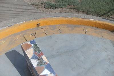

Ah, I spent a couple of years south of the equator and this is what everyone wanted to know - does the water go the wrong way round? In a past life I studied the Coriolos effect as a meteorologist but after more years than I care to remember working as a high school physics teacher, I wouldn't remember much about it now. Too much time in the company of surly teens kills brain cells ;)
I must confess that the movement of the stars and the sun was something that confused me immensely at first in the southern hemisphere - and then again in the north on return, but plug holes and toilet bowls I never lost much sleep over.
Sun clocks are definitely the wrong way round though
Concrete sundial with a yellow painted rim showing hour markings in Roman numerals, XII, XI and X visible, with a mosaic-tiled bench edge in the foreground.
  • Concrete sundial with a yellow painted rim showing hour markings in Roman numerals, XII, XI and X visible, with a mosaic-tiled bench edge in the foreground.
CW or CCW?
It all depends if the clock is facing up, or facing down.
Most people look at the rotation as if a top view is the most natural perspective, but a bottoms up view is just as valid.
