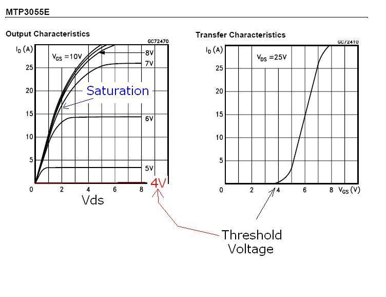

The "gate threshold voltage" is the voltage from gate to source when the drain current just starts to flow. Is this the "threshold voltage" you are after?
If you have a look at the atatched curves for a MTP3055 mosfet, it is clear that this voltage for this device is 4 volts from the RH curve.
On the left curve, you can say that it is less than 5 volts because this is the lowest Vgs curve shown. That is the bottom curve on the graph. If these curves were shown at closer intervals, you could estimate it closer than "less than 5 volts", but with this graph, you can't do better than that.
But you don't need to. It is clearly shown on the RH graph.
It has nothing to do with the saturation knee on the left of the curves on the left graph.
No that's not correct.
For example, take the first of your two graphs and the Vgs=5 trace (btw the x-axis on that graph should be labelled as Vds not Vgs). The point at which this curve just enters the constant current region (which for a fet is also referred to as the saturation region) is approx Vds=1 volt. From this we can predict that Vt = 5 - 1 = 4 volts. This follows directly from the (ideal) equations for a FET. Look them up.
The main problem here is that the FET may not accurately follow the ideal quadratic relationship too well for various reasons, see for example sokrates reply above. BTW, the above shown FET clearly does depart quite significantly from the ideal quadratic relationship at higher current levels.

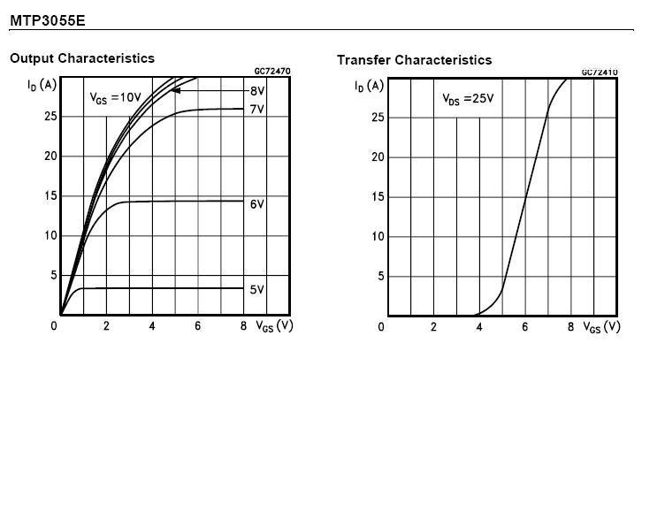

See attached diagram.
If you have a look at the attached curves for a MTP3055 mosfet, it is clear that this voltage for this device is 4 volts from the RH curve.
