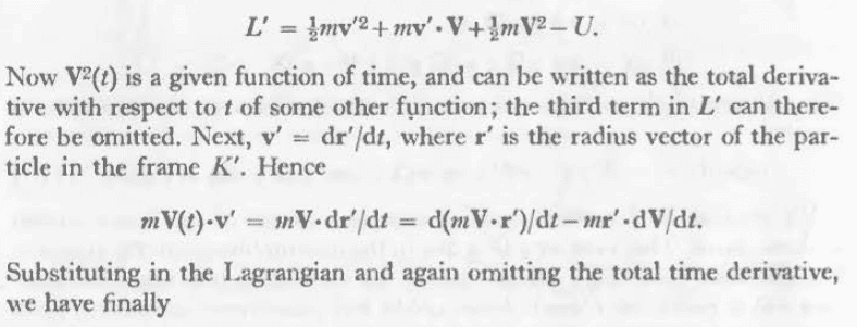

Hi,
in this Landau's extract i note that the total derivative is neglected in 2 places.
in the first case i think because it's raised twice, but in the second case?
A total derivative in the Lagrangian does not affect the equations of motion as it only contributes with a boundary term.
Orodruin said:
a boundary term.
sorry for my english, but what is that?
A contribution from the boundary that remains after integration. Think divergence theorem where the integral total derivative ##\nabla\cdot \vec v## is rewritten as a surface integral over the boundary of the original integration volume.
