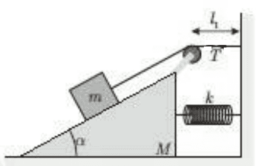

Homework Statement:: See the picture below. Initially, the system is at rest. Neglecting friction and mass of both spring and string,
a) what is initial acceleration of M? Assume initially the spring is at natural length ##L_1##
b) find the tension when the system moves for the first time
c) is total energy of system conserved?
d) after moving a distance ##x_o## towards the wall, M will stop. Find ##x_o##
e) find the equilibrium point of M, measured from initial position of M, when M oscillates
f) find the period of oscillation of system
Relevant Equations:: ∑F = m.a
Restoring force: F = k.x
ω = 2π / T
a) When the system is in motion for the first time, the force causing ##M## to move is contact force with ##m## so:
$$\Sigma F=M.a$$
$$N \sin \alpha=M.a$$
$$mg \cos \alpha \sin \alpha =M.a$$
$$a=\frac{mg \cos \alpha \sin \alpha}{M}$$
Is that correct?

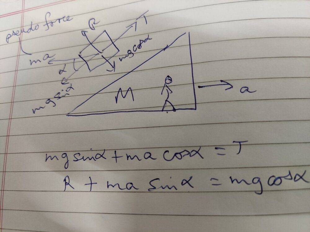

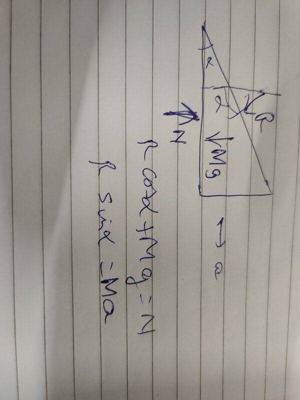

b) Is acceleration of ##m## the same as ##M## when the system moves for the first time?
Thanks
I think these types of problems where there is a motion within another motion or multiple motions relative to ground unfolding in a complex manner, it's best to use the accelerating object as a frame of reference i.e. a non-inertial frame of reference to simplify things and then add a pseudo force on the other object being observed from an accelerating frame of reference.
In this situation, let's have an observer on accelerating wedge. This observer will see the block m as stationary since it's tied to the wall with a fixed length string. If a is the initial acceleration of wedge then apply a force ma in opposite direction on block m. We are focusing on the instant t=0 since we need the acceleration of wedge at t=0.
Below are the FBDs that I get for block m relative to accelerating wedge and for wedge relative to ground. Note that at t=0 there is no spring force since the problem states that the spring is not stretched initially. The second FBD is relative to ground, while first is relative to wedge.
Block observed from wedge
  • #67
That was done in posts #25 and #27, except that horizontal and vertical coordinates were used.
