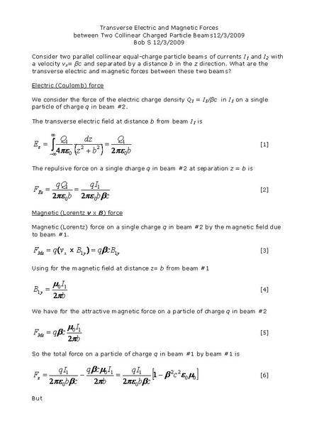

Bob S said:
See my post #25 in
https://www.physicsforums.com/showthread.php?t=359413&highlight=Coulomb+Magnetic+force&page=2
and this attachment
https://www.physicsforums.com/attachment.php?attachmentid=22256&d=1259869448
showing that the Coulomb field gets weaker, and the magnetic field gets stronger, as the velocity approaches c, where the two opposing forces cancel.

In charged particle beams, the charge density of the beam produces a radial electric field that produces a repulsive force on individual particles. See Eqn (4) in Karlheinz Schindl's paper
http://cas.web.cern.ch/CAS/Loutraki-Proc/PDF-files/I-Schindl/paper1.pdf
Simultaneously, the current of the moving beam produces a magnetic field that produces an attractive force on individual particles. See eqn (8). These two opposing forces are combined in Eqn (9) to (11), cancelling each other as β → 1. The cancellation is proportional to 1/γ2.
Space charge forces, both Coulomb and magnetic, are well known in charged particle beams, and cause emittance blow-up in low-β, high-current beams. The two forces cancel for very relativistic beams.
Bob S
