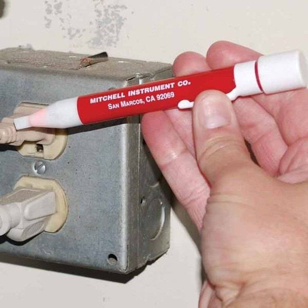

So yeah... Is there a way of doing " measuring " electricity and not using probes? Laser perked?
There are non-contact hand-held AC voltage detectors like the one below. But they are just threshold detectors, without a quantitative readout. They use the person as the "ground" reference for the AC E-field detection...
http://lghttp.17652.nexcesscdn.net/...8e27adf667b20d5f3db4b7e3a38cc2/m/i/mit751.jpg
Any instrument that can check quantitative value ? :) Not even star track could grasp this concept :)
