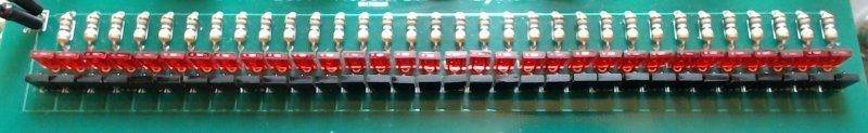

Here are a few photos to give an idea of what is to happen.
The LEDs will constantly be transmitting. They look for a blocked path.
When it moves to the right it will produce a square wave from 0% - 100% duty cycle.
When it moves to the left it will go from 100% - 0% duty cycle.

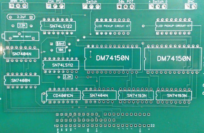

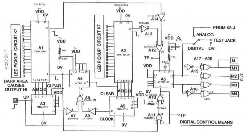

I am understanding that there are two channels.
Based on which channel lead/lags the other... the multiplexers have out puts at their (A, B, C, & D) outputs. (Note: This is probably an incorrect assumption.)
My main question is that...
What Feeds What?
1) Does the up counter (74193) feed the multiplexer (74150) as a switch? Therefore, selecting that LED.
2) Does the position of the blocked LED translate into a binary code? Therefore, selecting the condition of the multiplexer as a whole.
Asked another way:
1) Does the (74193) feed the binary selection to the multiplexer for the positions?
2) Or does the (74150) feed the counter with it's corresponding binary number?
The process as I understand it:
1) Clock Feeds Counter.
2) Counter counts up and outputs a binary number.
3) The binary number is fed to the (74150). Therefore, selecting the LED position.
4) Multiplexer outputs it's data.
5) Data enters the (74LS122)... and I'm not really sure what happens here.
6) Some signal runs back to the counter, multiplexer, and a JK Flip Flop (74LS112).
7) I believe this triggers the condition of looking at either multiplexer and determining which LED was blocked before.
8) Once it determines what way the blocked LED is traveling... it "okays" the data and says to increase/decrease your pulse width.
The following is a block diagram of the circuit. The pinouts may not be in the correct places on the block diagram.
I am having a little bit of trouble following the process and would like to verify that I am thinking about this in the correct fashion.
