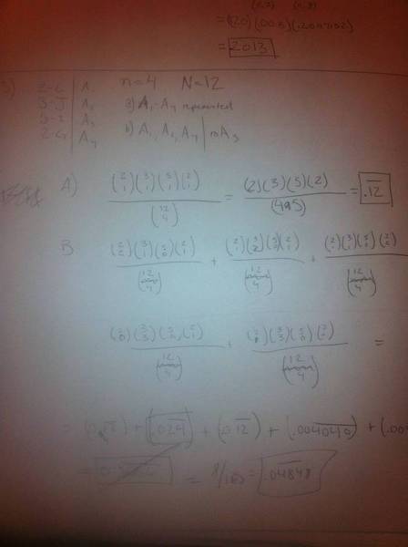

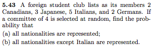

I worked out A) just fine it seems (given the answer in the book), but B) I'm not sure how to take this out. Below was a try but I'm not sure i was even on the right track. Any ideas?

In (b) you seem to have forgotten the cases (2,2,0,0), (0,2,0,2) and (2,0,0 2). Otherwise the basics are OK (but please in future try to attach more readable files: yours is incomprehensible on my laptop and on my i-phone; it shows up only on my desktop machine.)

"All nationalities but Italian are represented" So those three do not comply. It must have a zero for the third space, and contain at least one from each of the others, and must equal 4.
ok, I answered my own question. the last two i added in would not work due to the criteria. so i guess you helped, thanks RGV. I'll try and find a better format to post these in.

Sorry, I mis-read question (b). Your original solution is correct, and did not leave anything out (as I had erroneously suggested).
