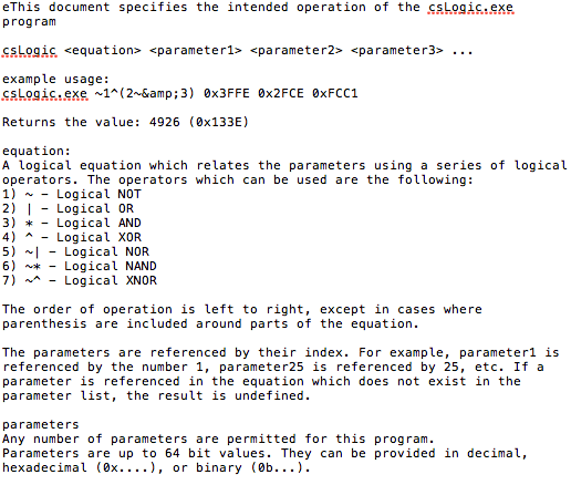

I started making a program with the following prompt (For privacy purposes, I'm posting it as an image).
Yes, it's a useless program; I'm making it for fun.

Anyways, can someone please criticize me in the most condescending way possible; and if you're feeling nice, maybe give me an outline of how to better approach this problem?

The whole point of the problem is to implement a calculator that uses postfix notation.
what you need to write is a line parser that breaks up things into tokens and then processes them using a data stack and an operator stack that is if you want to support parentheses.
I don't see why I can't do what I'm trying to do, which is an algorithm like

If you want to do this cleanly (i.e. without a monstrous program), take a look at the shunting-yard algorithm. This allows you to convert infix notation logical expressions to reverse polish notation, which is much more efficient to parse (using a stack data structure). The conversion and execution thereby only takes two passes through, which results in O(n) asymptotic complexity.
To clarify: You are taking in an expression is infix (as in 2+5), yes? Because postfix (aka reverse polish notation) does not have parentheses.
