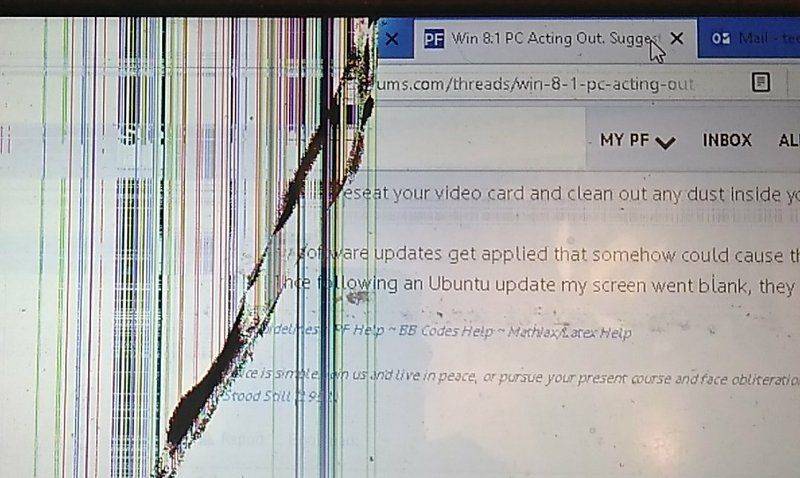

Maybe you could reseat your video card and clean out any dust inside your pc to prevent static discharge.
Also did any software updates get applied that somehow could cause this? I’d search to see if anyone with your pc model had this same problem. Once following an Ubuntu update my screen went blank, they eventually fixed it and said the wrong driver got applied.

Try to check your monitor first. Switch it off and back on. If the problem persists look at the cable connecting monitor to pc. See if it is loose.

Thanks, but this is not a desktop, it is a laptop, so cannot disconnect monitor separately. It may be possible to detach monitor from rest of laptop, but I don't have that level of game at this point. Also, since it is a laptop, there is no one cable connecting the monitor to the pc that I can tell.QuantumQuest said:Try to check your monitor first. Switch it off and back on. If the problem persists look at the cable connecting monitor to pc. See if it is loose.

I thought that you talked about PC in post #5 but no problem if it is a laptop then you have to connect it to an external screen in order to see if the problem is in monitor or graphics card (video chipset otherwise).

Can you borrow a monitor from someone who has a desktop, or take your laptop to their place and hook up to their monitor?WWGD said:How do I do that , given I don't have ( access to a ) lab?

Now I have been recorded in a picture for eternity.WWGD said:Hi All,
I have this cracked eView attachment 218430lectronic screen. Any suggestions, please?
If it is a modern monitor, HDMI is to be likely. If it is a projector chances are it will be VGA. Perhaps DVI, but I've rarely seen laptops with DVI. They usually have HDMI, VGA or both.WWGD said:Thanks, sorry if this is a dumb question, but, what type of cable do I use to connect my laptop to a monitor?
If you have a TV, you can try on it.

Has anything hit that side of the screen, for those lines to occur? e.g. dropped

By PC, do you mean the hardware?WWGD said:The PC itself is cracked, not sure how it happened, but the screen itself is not cracked, thanks.
What @jedishrfu said is on spot. Drivers can cause problems like that sometimes. Your options would be
1. Rollback the video drivers
2. Update the video drivers
3. Do a System Restore
Some people start with option 3 because it is the easiest to find and covers pretty much everything software related. For options 1 and 2, you can enter Safe Mode and do it from there.
Does the screen appears when you enter the BIOS/UEFI utility looks fine? If it all shows good on those utilities it is most likely a driver problem.

That sure looks like the classical physically damaged screen! The vertical lines on the left indicate a disconnect from the screen driver chips that do pixel addressing. The jagged black feature indicates fractures of one of the glass layers making up the screen.
I suggest taking it to a computer repair shop for a visual inspection and verification; they see a LOT of those instances. Used replacement screens are usually available for around USD$100. Replacing them though is definitely not a job for the inexperienced!
p.s. You got lucky. If that much of an impact occurs while the computer is running, the Hard Drive is usually destroyed too.
