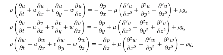

Hello! :smile: I am going over an example in my fluid mechanics text and I am confused about a few lines. My question is more about the math then the fluid mechanics. In fact, I doubt you need to understand the FM at all; if you understand Diff eqs, you can probably answer my question.
I am given the components of the velocity field:
[tex]u = a(x^2-y^2)\,\,\,\,\,\,\,\,\,\,\,v = -2axy\,\,\,\,\,\,\,\,\,\,w=0[/tex]
and I am also given that gravity only acts in the downward z direction [itex]g_z = -g[/itex].
The example question asks to first determine under what conditions the given velocity field is a solution to the Navier-Stokes equation. Then, assuming that these conditions are met, determine the resulting pressure distribution p(x,y,z).
The Navier-Stokes EQs are given by:
Their approach is as follows. They say
Assume steady state flow and let viscosity [itex]\mu[/itex] and density [itex]\rho[/itex] be constant. Substitute the known (u, v, w) into the N-S equations and solve for the pressure gradients. If a unique pressure function p(x,y,z) can be found, the given solution is exact.
1st question: what do they mean by exact? What would it mean to not be exact?Alright, now after a whole bunch a solving that you don't need to see, we end up with the following pressure gradients:

Okay:
1. Remember that the curl of the gradient of a scalar function is zero!
2. The converse is also true:
IF the curl of a vector field is zero, then that vector field MUST be the gradient of a scalar function!
Thus, by making the "cross-differentiation", what you are actually doing is to compute the z-component of the curl, and finding out it is zero.
The x-and y-components of the curl are trivially zero, since differentiation of the vector field's x-and y-components with respect to z yields 0, AND the differentiation of -pg with respect to x-and y- also yields zero.
YOu can also solve this explicitly as follows:
[tex]\frac{\partial{p}}{\partial{z}}=-\rho{g}\to{p}(x,y,z)=-\rho{g}z+H(x,y) (1)[/tex]
where H is some function of x and y.
[tex]\frac{\partial{p}}{\partial{x}}=-2a^{2}\rho(x^{3}+x^{2}y)\to{p}(x,y,z)=}}=-2a^{2}\rho(\frac{1}{4}x^{4}+\frac{1}{2}x^{2}y^{2})+F(y,z)(2)[/tex]
[tex]\frac{\partial{p}}{\partial{y}}=-2a^{2}\rho(y^{3}+y^{2}x)\to{p}(x,y,z)=}}=-2a^{2}\rho(\frac{1}{4}y^{4}+\frac{1}{2}x^{2}y^{2})+G(x,z)(3)[/tex]
Now, these three expressions, (1),(2) and (3) for p must specify the SAME function!
We can do this by setting:
[tex]H(x,y)=-2a^{2}\rho(\frac{1}{4}x^{4}+\frac{1}{2}x^{2}y^{2}+\frac{1}{4}y^{4})+K[/tex]
K being a constant.
[tex]F(y,z)=-2a^{2}\rho(\frac{1}{4}y^{4})-\rho{gz}+K[/tex]
[tex]G(x,z)=-2a^{2}\rho(\frac{1}{4}x^{4})-\rho{gz}+K[/tex]
Thus, (1), (2) and (3) represents the SAME equation, and we get the final pressure distribution:
[tex]p(x,y,z)=)=-2a^{2}\rho(\frac{1}{4}x^{4}+\frac{1}{2}x^{2}y^{2}+\frac{1}{4}y^{4})-\rho{gz}+K=-\frac{a^{2}\rho}{2}(x^{2}+y^{2})^{2}-\rho{gz}+K[/tex]

OKay:
1. You were given a velocity field.
2. You were asked to verify that this can, indeed, be a valid solution to the Navier-Stokes equations.
3. If it is to be a valid solution, then it must be possible to find a SCALAR FUNCTION "p" that can play the role of pressure.
4. By taking the curl of the given vectorial expression, we find that this is 0, i.e, that N-S has been reduced to a GRADIENT expression for the pressure.
5. Therefore, the given velocity field CAN BE a valid solution to the N-S equation.
6. If 4. had given something else than 0, then your velocity field is unphysical, in the sense it cannot be a solution to the N-S equation.
