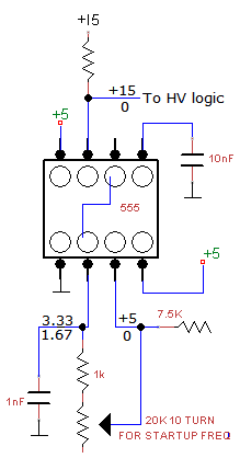

imsmooth
154
I have a 555 running off of 5v. I want this signal to control another IC running off of 15v so the output toggles between 0 and 15v. I tried a 4069 hex inverter, but when it runs of 15v the 555 running off of 5v does not reach the logic HIGH threshold. I tried using a FOD3180 coupler, but did not work. Is it that the 555 does not have enough output current to drive the 3180?
I have 1k resistor coming off of pin3 on the 555. Is there a hex inverter that has a sub-5v threshold for logic HIGH that would work?

You must look at, (and understand), the internals of the 555, not the published circuits that are confusing.
I think of a 555 as having two outputs.
Pin 3 is the regular high-current bipolar output.
Pin 7 is an open collector output, called disch.
You could modify the circuit to make a square wave oscillator using pin 3, (not pin 7), to drive the frequency selecting pot circuit. Keep pins 2 and 6 connected to the same capacitor.
Pin 7 is then separate and available, so it can drive the higher voltage logic, with a pull-up resistor to the +15V supply.

Thank you. What I'm trying to do is drive the higher logic with no more than 5v. All the inverters I've looked at have different threshold depending on the value of Vcc powering the chip. The mosfet drivers 4421 and 4422 seem to need a low threshold current to switch logic states. It also has an internal signal clamp at 4.7v so it should respond the way I need with the 5v logic signal.
Are you saying that the two circuits have different zero volt references?
When designing electronics, the schematic diagram surpasses written language.
