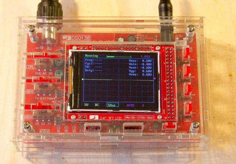

But, initially to measure the frequency I used an oscilloscope (DIY DSO138) which I have to run from 9V, and having only one adjustable power supply I initially run the oscillator from 9 V as well.
Later I switched the oscillator to 5V - and things got weird. Not only the frequency has changed, but also the duty cycle, and the upper voltage is not constant, it is rising a bit during the "on" phase.

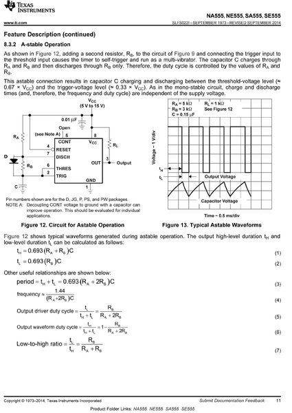

For the basic 555 astable circuit see pg.11, fig.12 of: http://www.ti.com/lit/ds/slfs022i/slfs022i.pdf

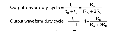

Then add "D" as shown at the left edge below. This makes
  • Output High time = 0.72 x RA x C (approx. - the 0.72 makes RA a little lower than expected to account for the diode drop.)
  • Output Low time = 0.693 x RB

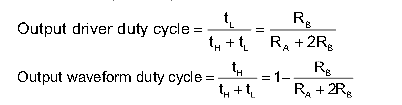

Set either of these to 50% and solve for ratio of RA to RB
page 11 of datasheet
0.5 = RB / (RA + 2RB)
0.5 (RA + 2RB) = RB
RA = 0 which shorts supply during discharge.
A constant current source in place of RA might be made to work.

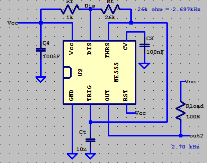

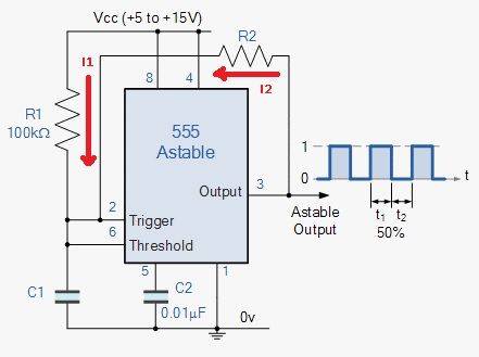

Here is what i think is happening:

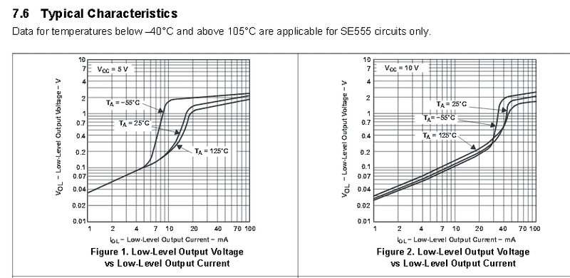

When driving significant load a 555's output voltage won't make it to the supply rail, it'll sag.. @Baluncore mentioned that earlier. It's one of those pesky little things about 555's .
Observe your 'scope photos
high state output is 3.86 or 7.65 volts
and
that is 1.14 or 1.35 volts short of your 5 or 9 volt supply.
What are implications of that ?
<<< RUNON SENTENCE ALERT - PARSE CAREFULLY>>>>
So - while voltage at capacitor swings between 1/3 and 2/3 Vsupply, because the 555's internal divider tracks Vsupply and that's why 555 is usually pretty indifferent to variations in Vsupply,
BUT
in this schematic -
voltage that's doing the charging, Vout, doesn't track supply nearly so well as the 555's internal voltage divider .
That divider establishes Trigger and Threshold points at 1/3 and 2/3 Vsupply..
So C1's charge time is affected by output voltage sag.
That shows up in your 'scope photos - look at how much longer is 'high' state at 5 volts than 9.
C1 charges while output is high and discharges while it's low.
During charge time I2 flows as red arrow shows, during DISCHARGE time it flows opposite.
With 5 volt supply charging volts to R2 is only 3.86/5 = 77% what it should be so charging is slower than expected and HIGH state is inordinately long...
In fact , voltage across R2 is nominally 3.86 - 2.5 = 1.36 instead of 5 - 2.5 = 2.5 .
That means I2 is low to tune of 1.36/2.5 = 54% and your scope shows high state is nearly 50% longer at 5 volts than at 9.
With 9 volt supply, charging voltage to R2 is 7.65/9 = 85% what it should be and I2 is nominal 79% what it should be, a vast improvement over 54%..
So, when supply voltage changes, the charge time changes accordingly, hence frequency, all on account of output sag..
That suggests-
An interesting experiment would be to try your circuit without the buzzer. Then only load on 555 is charging current of a milliamp or less. Then the output should hardly sag at all giving you more consistent charging voltage.
If that squares away the duty cycle and frequency, the mystery disappears which in my book is plenty of payoff by itself.
It also opens the door to a simple fix -
Connect your buzzer between Vsupply and DISCHARGE pin. DISCHARGE pin can sink as much current as Output pin , just can't source any, but with that connection it isn't asked to..
worth a try ? I'm always up to learn something.

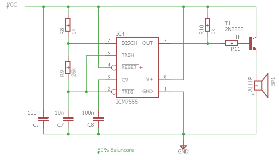

Can you please measure the DC resistance of the buzzer. That will tell us if it is a coil of wire or a piezo element.
If it is a coil of wire then connect it between the positive supply and output to pull the output signal up that last volt.

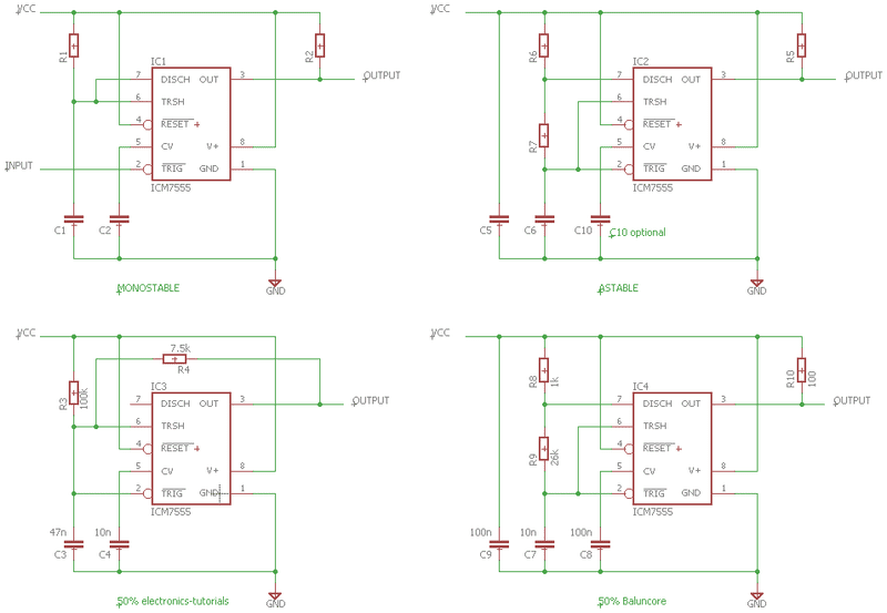

OK guys, sorry to keep you waiting - it is not that I ignored your posts, just got sidetracked by the real life.
First of all, to make things easier (for me) to analyze, I combined all the important circuits together, using identical convention and as similar placement of elements as possible. That helped me realize that Baluncore circuit is just a standard astable configuration, so the duty cycle should be 25/(1+2*25) = 25/51.
Second - I am chaotic and lousy :frown: Net effect is that I am not able to reproduce some of the results I got earlier. At least in one case I misconnected the wire and I was measuring the frequency of the floating output (should it really matter? I understand high load can be a problem for the reasons Jim described, but lack of load?).
Third - the buzzer has a DC resistance of 15 Ω (but it probably doesn't matter, see below).
Four - frequency change when changing the supply voltage is most likely not because of the load connected to the output. While in some of the tests I did buzzer was connected directly to the output, initially I was not aware of the fact I can draw 200 mA from the chip so I connected the buzzer through a 1 kΩ (or 100 Ω) resistor and 2N2222 transistor, I assume that means the load was negligible.
Today I did another trial, using Baluncore's circuit, again with a transistor and with a much higher Rload (1 kΩ, can't use 100 Ω as the transistor gets saturated):
When changing voltage the duty cycle remains almost constant, but the frequency again changes from 2.7 kHz at 5 V to 3.3 kHz at 9 V.

@Borek.
Just a couple of notes.
You have big changes of load current on the supply. Accurate timing is dependent on Vcc remaining stable throughout the cycle. Have you looked for noise on your Vcc rail?
The Spk1 resistance of 15 ohms indicates an inductive winding. You need to look at the voltage across Spk1 to see if it has a negative spike when it turns off. Emitter followers are less suseptable to flyback damage, but you might need to place a reverse biased power diode across Spk1 as a flyback diode to catch any off spike.

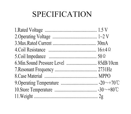

From CFDR-02 datasheet at http://download.maritex.com.pl/pdfs/ac/CFDR02.pdf
With 50ohm impedance 5 volts is 100 milliamps.
I think i'd try driving it through a capacitor sized to set current to about 30 milliamps at whatever is desired operating voltage.
Thoughts ?
Yikes! And the thing is rated at 1.5V.
If the frequency isn't required to be 2700Hz, how about the CFD06 or the CFD12 at 2400Hz? (They are cheaper too. Only important if you are buying lots of 'em.)

The only explanation I can see for that frequency variation is an unstable power supply.
You could pull the 1k0 base resistor R11, or pull the 2N2222, to see if frequency still changes without the extra load on the supply. Does disconnecting the load change the frequency or the supply voltage?

The ICM7555 datasheet shows frequency vs. supply voltage stability of 0.5% per Volt; so a power supply, wiring, or electrical noise problem are prime suspects. If you have access to an oscilloscope, troubleshooting should be rapid, even long distance. No worries if not. It's a simple enough circuit that there is only a half dozen or so causes. Any chance you can post a photo of the actual build?
Also suggest that R10 be changed to 1k8 to ensure cutoff of T1. R10 minimum is set by IC4 output characteristics and threshold voltage of T1. The ICM7555 is a CMOS device with only a few milliamps sink current and less than 1mA sourcing current.

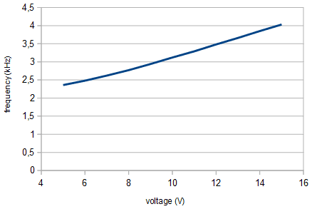

I am baffled more and more (and you will be probably too). I understand how the 555 is designed around the idea of "self compensation", that is, it should work reliably regardless of the Vcc. But, somehow it doesn't behave as expected for me.
The voltage from the power supply is fairly constant. My power supply (KORAD KA3005D) is rated 30 V 5 A, so I assumed I am quite far from stressing it, but better safe than sorry, I have checked that when using 15 V the oscillations are in the 35 mV range. Perhaps not perfect, but definitely way too low to explain the problem.
I modified the circuit again, to use well behaving, small load:
and it didn't help:
Looks like the frequency depends quite linearly on the Vcc. Also, after powering the circuit frequency goes slowly up as if some element characteristics was changing with the temperature (but even at 15 V nothing was warm to touch).
Replaced the IC with another one from the same batch, no changes. They bear the Texas Instruments logo and I bought them in a place I don't expect to be distributing any counterfeits.
Circuit is a wire mess on the breadboard - can it be source of problems?

Actually I am not sure it is rated 1.5 V. From my googling (and from my attempts at finding the element in places where I can buy it for a reasonable price, without paying an arm and a leg for p&p) looks like there are at least three variants bearing the same symbol, but rated for different voltages.

Perhaps that is an European thing, transistors in all circuits in my books are marked with T and it is a default symbol used by Eagle. Actually each time I see one marked Q I wonder WTH?
Oops! I keep forgetting this is a truly worldwide forum. My reference designator comment was from North America, USA specifically.. Sorry.:sorry:
The timing cap, C7, should NOT be a ceramic, they change value with applied voltage and can be slow to recover. Try something with a paper or plastic (film) dielectric. Ordinary Aluminium electrolytic caps may have the same tendency, and they drift with age. Tantalum electrolytics seem to be fairly stable though.
Capacitor it was! Today I bought 10 nF of every kind the shop had, and apparently the kind I started with (ceramic one) is the worst, others (especially MKT) behave much better, difference of 30 Hz between 5 V and 15 V is not that large. Interesting practical lesson about real elements :smile:
jim hardy said:
You have a 'scope, right ? Two channel ?
Unfortunately - one channel only. But for $30 I am not complaining.

re: Scope
$30, I'm interested. (Don't like hauling around my 40 pound mini-monster.) What is it and where are they available?
DSO138 - digital oscilloscope, 1MHz sampling, DIY kit. Takes an evening or two to solder. It is sold in two versions at least - one has SMD ICs already soldered (just 2 or 3 of them). $30 is with an additional acryllic case (otherwise you are left with a bare PCB). I got mine from aliexpress (or was it banggood?), but I see them everywhere - including amazon and ebay.
It is in many ways limited (and a bit quirky to deal with with just several buttons) but it is also small, cheap, and - as was proven in this thread - it works. There are several reviews on youtube where people compare it to much more expensive equipment, so you can see it in action there.
You will need a 9V power supply (0.1 A I think).
Not connected to any signal here, but I already posted screenshots with signal from 555 earlier in the thread:
