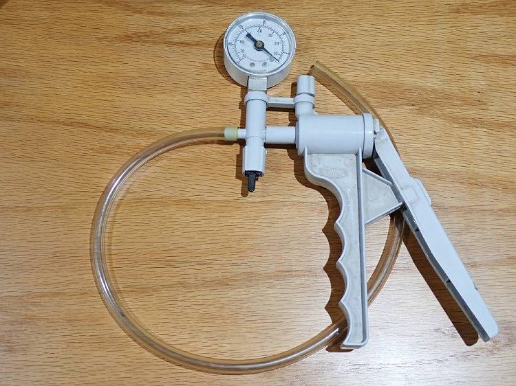

I need advice on what type of vacuum pump would create max negative pressure in a very small area ( a space no larger than your pinky finger I guess) ? Maybe some kinda high suction low cfm pump? I don't know enough about vacuum pumps to know which type to use for my application. And advice would be greatly appreciated.
Peristaltic pump (roller pump). Cheap diaphragm pumps also works fine for low airflow, high suction pressure applications.
P.S. Never apply suction port on a body parts. Injury is guaranteed if applied.
Ok, I've not researched that particular pump... I'm trying to achieve an insine amount of vacuum. Kinda like if you poked a small hole in a space ship. The amount of force focused near the hole... will a roller pump achieve that kinda pressure in a small area? a lot of the roller pumps I've seen look like they are for medical applications... and more advice would be greatly appreciated

The maximum amount of vacuum in air is 14.7psi, and it isn't difficult to get pretty close to it.
This little sucker (pun intended) just pulled 27 inches of mercury with my finger stopping the tubing. I think it would do better if I shortened the tubing. Trade name is MityVac. Harbor Freight has something similar: https://www.harborfreight.com/brake-bleeder-and-vacuum-pump-kit-63391.html.
I used that same vacuum pump with an Edmunds Bell jar for a number of experiments. Plus, I used it to bleed my sportbike brakes for years. A great investment! :smile:
