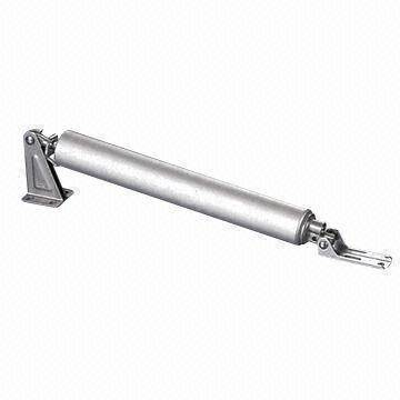

Will an ordinary pneumatic door closer not do the job? I see them for under 8 GBP.
Yes - probably and it's true that I should just let go of this but I wanted to use something that was definitely suitable for outdoor use - not the most rational of choices. It's turned out to be a project, rather than just a gate spring. :wink:
