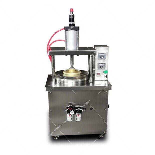

If there is no cooking, then there is no need for the circular plates on the production line. A simple roller based system could be used. That would eliminate the handling problems of loading the lump of dough, and removing the pressed tortilla. That also eliminates the compressed air, the pneumatic cylinder, and most of the cyclic control.
We can try to reverse engineer from a picture of a unit with a 300 mm plate.
Plate outer diam = 224 - 27 = 197 pixels. That is 300 / 197 = 1.523 mm / pixel.
Cylinder diam = 162 - 84 = 78 px; 78 * 1.523 = 118.8 mm; Probably 4 inch bore.
Rod diam = 138 - 116 = 22 px; 22* 1.523=33.5 mm. Probably 1.25 inch diam rod.
Stroke = 215 - 141 = 74 px; 74 * 1.523 = 112.7 mm. Probably 4.5 inch stroke.
Scale by area of circle. Area = Pi * r^2
Area of 280 mm (11") tortilla = Pi * ( 11” / 2)^2 = 95.0 inch²
Area of piston in cylinder = Pi * ( 4” / 2)^2 = 12.5 inch²
Assume air pressure is 100 psi, then force = 12.5 * 100 = 1250 lbs on rod.
That works out at 1250 / 96 = 13.0 psi on the tortilla dough.
To press an 8” diameter, with area = Pi * (8 / 2)^2 = 50. inch²
You will need to press 50 * 13 = 650 pounds.
Using the same 100 psi air you need a cylinder area of 6.5 inches.
Sqrt( 6.5” / pi ) = 1.43” radius = 3” diameter pneumatic cylinder.
A 1 inch rod would be sufficient.
The stroke would not change, it would remain about 4½ inch stroke.
