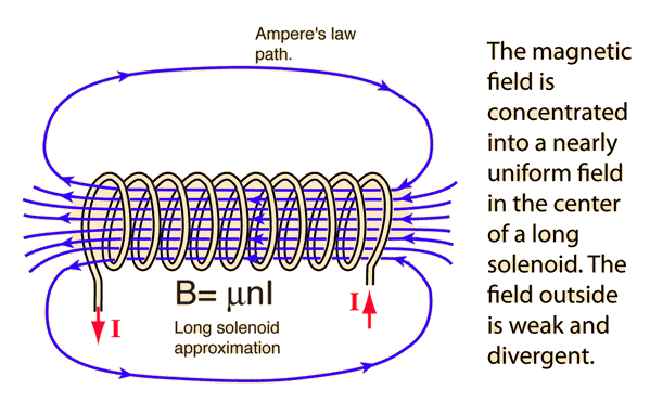

When a current goes through an inductor it creates a magnetic field. You just need to accept that or watch some feynman physics lectures (well, youtube might have some videos, too) Creating that field required energy. When you initially apply voltage to an inductor, initially there is no field. The current slowly starts ramping up as the field is created. (di/dt is created by V based on the inductor size) The formation of the field resists (slows, or impedes) the growing current. An ideal inductor has no ohmic resistance so the current, and the field, can grow forever for any given V. If I stop the current from growing (which, strangely enough, leaves zero voltage across the inductor since di/dt is zero), the field is simply maintained. If I reduce the current, the field collapses some while trying to keep the current the same (and a voltage results).

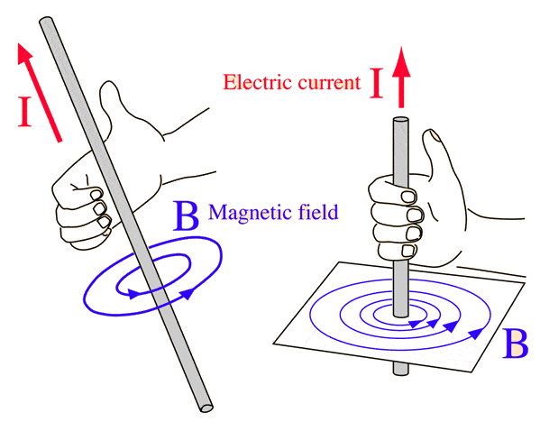

magnetic field around a wire , courtesy http://hyperphysics.phy-astr.gsu.edu/hbase/magnetic/magcur.html
arranging the circuit for more inductance

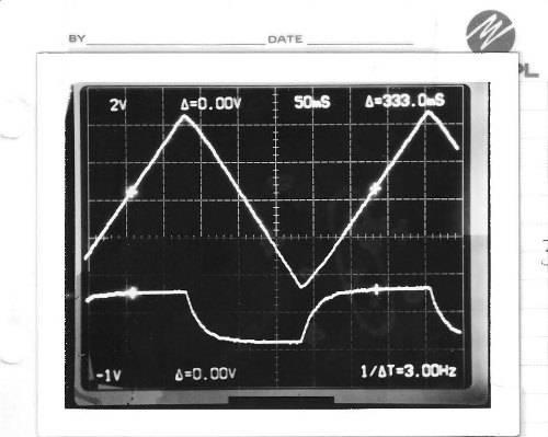

Here's an actual 'scope photo of volts across an inductor with a triangle wave current
current above, ~20 ma p-p
voltage below , somewhat less than a volt p-p
Triangle wave current has two distinct slopes
and (almost) square voltage wave has two distinct levels,
which to me is visual proof e = L di/dt.
(Rounded corners of squarewave are a secondary effect from imperfect iron core in this inductor. They weren't there with air core.)

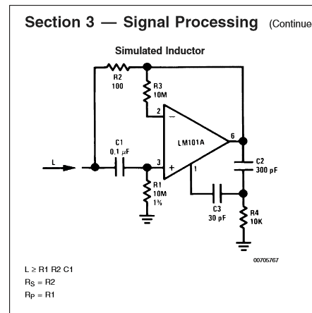

i once used this one, from old National appnote AN31 ?
http://www.ti.com/ww/en/bobpease/assets/AN-31.pdf
but GIC is new to me...

LvW said:
PS: Keyword GIC can be found in wikipedia.
Doesn't seem to be one. Do you have a link you like for GIC. Can it emulate ideal inductors? or is it someone limited like the Gyrator.

Sorry - you are right. I was of the opinion that wiki has a description. As it seems - that is not the case.
Here is a good link (GIC for an "ideal" inductor - as far as a real opamp does allow it):
http://forum.allaboutcircuits.com/attachments/gyrator-inductor-options-pdf.9108/
(Sorry - this works only if you are registered/logged into the site). Therefore, I have nclosed a pdf paper (active inductor on page 10).
Such a two-opamp circuit is often used in active filters (active realization of LRC structures).
A comment to Jim Hardy`s circuit: This is one version of a LOSSY inductor; however, I think it is an equivalent to a real inductor (coil) in the frequency domain only (sinusoidal signals in the time domain).
It does not mimic the true step response of a lossy inductor.

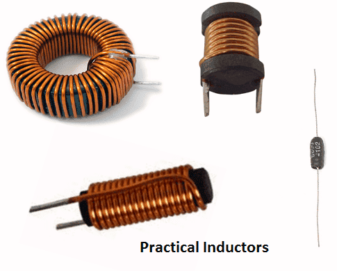

Bringitondown said:
not insulated
As NO says, they are generally insulated. "Magnet Wire" has very thin insulation, since the voltage between adjacent turns is usually low. You can get magnet wire with standard thin insulation, or with "double build" or "triple build" insulation thicknesses, if you need more insulation or if you need the extra physical strength (with very fine magnet wire).
Smashing thanks for clearing that up. I don't like to leave things to assumption.
Bringitondown said:
What has thrown me is that in some pictures of the components stated it looks like there is no insulation, but from your reply I assume that there would be some sort of clear insulating varnish or something similar.
The transparent varnish is termed "enamel". Motors, relays and other electromagnets are wound using such enamelled copper wire.
The volts between adjacent turns are very low so thin enamel coatings are sufficient and allow close packing. I believe that the layers are sometimes separated by an insulating tape as the volts will be n times what's between adjacent turns. (nV volts for n turns per layer). It's a very practical business.
