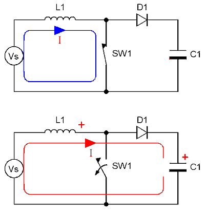

The ballast basically converts 120V AC from the wall to 600V AC or DC.
The first stage of the circuit converts 120V AC from the wall to DC voltage via the bridge rectifier.
The generated DC voltage is then tapped by R1 to supply power to the chip U1 which is basically an oscillator, or AC generator which drives the two mosfet transistors - that is it switches them on/off at some frequency.
The final stage of the circuit is a boost converter where the inductors are switched on/off by the mosfets and that induces higher voltage.
The boost converter work something like this:

The only left ones are C2 and C10. At the second glance they are kind of mysterious to me too. This isn't your typical boost converter. But what basically happens is: the mosfets are switched alternatively - one is on while other is off - and this creates a switched current source and sink.
When in current source mode (top mosfet on, bottom off) , a pulse wavefront runs through C2 (remember capacitors acts like resistors at AC) and energizes the coil.
When in current sink mode (top mosfet off, bottom on), the current in the energized coil is sucked back into ground by the current sink while higher voltage develops.
This is repeated on/off at some frequency, I don't know what they run like, could be 1000 times a second.
And C10 along with R3 just maintain correct voltage levels.
