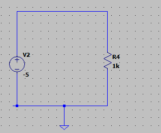

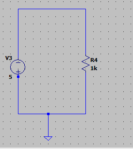

Need to understand the circuit as shown below
I am confused with the negative voltage supply connections in electric circuit. If i have circuit as below with -5V source
it is same as below
In the 2nd circuit the 5V is directly shorted with the ground, does it mean the circuit is not correct? Am i missing something? Please advise.
As long as the voltage source is floating (like a battery), it can be connected in either polarity.
Many/most DC lab power supplies float the +/- outputs so you can do just that (or stack multiple power supply voltages), and they usually make an Earth Ground connection available as well in case you want to use it.
https://eleshop.eu/korad-kd6002d.html
The 'ground' for such theoretical questions is just the declaration of the reference level/point.
Since it is the reference, usually it's taken as the 0V. So those drawings declaring the ground at 5V or -5V are not really the best: to have the other (not ground-connected) output of the voltage sources marked as -5V and 5V would be better.

Thank you for reply, i really did not understand, how the circuit will look like with the above changes.
In spice, node 0 is always ground, and that reference is needed somewhere, or you can't measure voltages. A voltage source can be created and connected between any two nodes in the circuit.
You can change the circuit polarity by changing the sign of the voltage, or by swapping the connections or nodes.
Try this spice directive (with two text lines) to declare and connect two voltage sources, Vc and Ve.
Vc Vcc 0 +5
Ve Vee 0 -5
That will create two power supply nodes or rails, one Vcc = +5V, the other Vee = -5V.
Any pin or node labelled Vcc or Vee will then be connected to a supply rail.
Try swapping nodes and polarity to confuse readers, or yourself later.
Vc 0 Vcc -5
Ve 0 Vee +5
