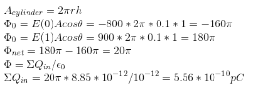

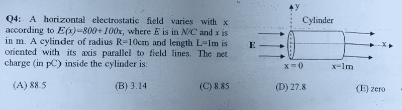

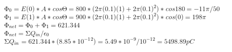

Here's my work :

Your expressions for the areas don't look correct. When calculating ##\Phi_0##, what particular area are you working with? What is the formula for this particular area ?

Which parts of the surface of the cylinder have nonzero flux?

The area that we're concerned will be the surface area of the ends of Gaussian surface which is equals to π / R^2
Φ = E A = Q enclosed / ε
Q enclosed = ## 100 * π * (0.1)^2 * 8.85 = 27.8 pC ##
Of course you mean π⋅R^2.
Q enclosed = 100 * π * (0.1)^2 * 8.85 = 27.8 pC
This is correct.
