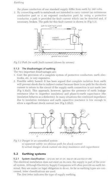

Suppose neither line is grounded. As wire insulation ages it may crack or become worn and allow a small amount of current to flow to ground. If hundreds of homes are connected to the same transformer there could be appreciable current flowing to ground even if all the lines have fuses or circuit breakers.
Someone who knows that both lines are floating, confidently if naively, sits in a bathtub full of water using a hair dryer. As the hair dryer gets wet, a small amount of current may pass from one line in the hair dryer through the person's body to ground where due to the leakage current from many other homes, the current finds a path back to the other line. Where would you put the ammeter in series with ground to prevent such an occurrence?
i feel like I am being misunderstood. Forgetting hypotheticals and taking one specific example. I have a lamp, plug it into a wall and float it from the middle of a ceiling. Can I determine the leakage of the lamp (diff between line and neutral) by measuring Earth current?

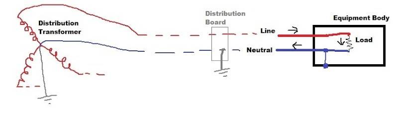

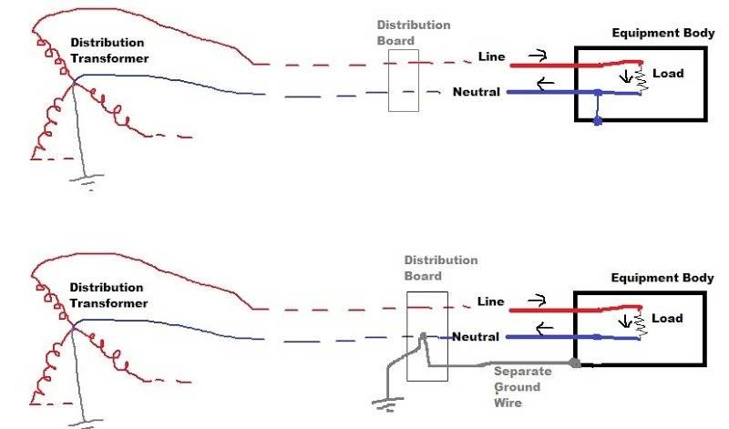

I_am_learning said:
"Why don't we connect the neutral itself to the equipment body and totally eliminate the use of ground wire?"
Because we don't normally want current flowing through our equipment bodies. We would rather keep it in the wires.
  • #56
Perhaps a Diagram would help.
The Upper Diagram is what I am asking about. The Lower Diagram is the usually practiced scheme.
In the upper diagram, connecting neutral to the equipment body don't make the current flow through the equipment body as you were thinking.
So, I was asking what are the bad things about the protection scheme of the Upper Diagram?
Edit: Updated the Image as per suggestion of Evil_Bunny
  • #57
Good question...
First of all, the drawings are incomplete. The neutral and the "seperate ground wire" are attached together at the distribution panel. This would be located in between the equipment body and the distribution transformer (more specifically, at the service entrance to your house, at the distribution panel). This creates a parallel path for the return (the normal path would be the neutral and the alternate parallel path would be the grounding conductor).
If this part were included in the drawing, you could see the problem more clearly.
One "bad thing" that could happen in the upper diagram is an open neutral. In this case, your equipment would be at full potential. If you were touching the equipment, the return path would be through you and into the ground you're standing on (as the current will try to make it's way back to the transformer)... a dangerous situation.
With the grounding conductor attached (as would be illustrated in the lower diagram if the distribution panel were included), the current would flow safely through the alternate path (the grounding conductor) and back to the transformer.
It's just one more layer of safety built into the design.
Under normal conditions, as you seem to realize, there would be little danger with the upper diagram. The danger arises when there is a problem... such as an open neutral.
  • #58
Good Answer. :)
I Totally Understood the dangers involved in the top drawing, that the neutral conductor should breaks somewhere up-stream then the equipment body comes LINE. A Dangerous Situation.
So, I was thinking of modifying that drawing to avoid that situation.
But, I now realize that it is still less safer than the separate ground wire scheme, because, should the neutral wire break in in-between the Distribution-Board and the equipment, its again the same thing as the previous case. So, even this modified scheme can only protect from up-stream neutral break, Should the neutral Break in our house, its still Dangerous.
Hence, the Separate ground Wire Scheme.
Thanks a Bunch. This cleared up my long standing confusion.
