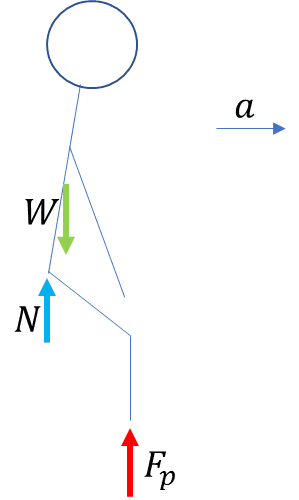

I'm sorry for the confusion. Those were just general thoughts on the mechanics of pedaling a bike (exploration for the sake of amusement). They weren't supposed to be specifically applied to solve this problem.
erobz said:
Ok, I can see that as possible. Imagine a riding without hands in a sitting position and standing up during the downward pedal stoke. It's very difficult to do in practice...I've tried it.
I did not say it would be advisable. It was merely a theoretical statement regarding the possible size of the pedal force.

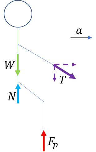

jbriggs444 said:
Absent toe clips or a firm grip on the handlebars, it is difficult to achieve an average downforce on the pedals in excess of the person's weight. Acceleration can help with peak force. Not so much with average.
Well, maybe if one is cycling in the globe of death.
Which is why I had carefully added the word ”instantaneous” …
Edit: When attending a conference in Beijing some 9 years ago or so I also visited an acrobat show. The globe of death act was great. 8 motorcycles in the globe at the same time.

Orodruin said:
But the problem in essence asks about the force on the rider — not rider+bike.
But the bicyclist can’t push the pedal downwards and the bike uphill without having the bike pushing his mass along, so he stays on the pedal during the slowdown process.
Want it or not, his energy or work is accelerating the mass of the bike and his own mass simultaneously, while gravity is doing the opposite work, ...and winning.

In that case, it's not important that the cyclist is the one putting the energy into the system. The original question was:
paulimerci said:
Homework Statement:: A 65 kg cyclist on a 10 kg bicycle is moving uphill on a 9° slope. How much force does he provide
if the bicycle slows at a rate of 0.3 m/s2?
Just change bicycle/cyclist for car/driver:
A 65 kg driver in a 1000 kg car is moving uphill on a 9° slope. How much force does he provide if the car slows at a rate of 0.3 m/s2?
The answer is the same. But saying that the driver provides the force in this case is, I would say, simply wrong.
