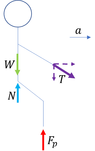

Ok, I think I'm seeing it. That force applied to the pedals can grow in the direction normal to the slope due to the gear ratio.
Or reduce. That's the purpose of low gears.

What gears do wasn't my issue of contention. It was the interplay between the various forces that is the subtle bit to me.
If this is a person cycling on horizontal ground (while sitting) with acceleration ##a## and ##F_p## changes from a change in gears, the only other force that can change is ##N## in this model. This is what I was not initially picking up...not "what gears do".

That’s not a very accurate model to be honest. All of those forces except weight will generally be in other directions. Weight will generally not be concentrated right above the saddle. The typical connection at the steering rod is leaning on it, making the force from the rod be up and backwards.

If you imagine a bike suspended above the ground, then there would be no linear motion, but the force on the pedals would drive a rotation of the back wheel. The ratio of rotation of the pedals to rotation of the back wheel is critical. Unless the back wheel slips then this determines the speed of the bicycle when accelerating or going uphill. That determines the force required to move the pedals, notably when starting from rest.
I still think it captures the basic idea. You can ride a bike like that. Sit on the seat, arms in tension as a two force member (fixed by rider + bike geometry), pedals pivot and the applied force stays pretty vertical on them. The part with the weight being not directly above the saddle...I'm not analyzing torques? There are some friction forces missing at the saddle and the pedal, but they would be fixed by the acceleration. If you rapidly change to a high gear and try to maintain acceleration you can start to come off the seat. I never said it was accurately capturing all ways of riding a bike...it's a crude model, first round draft to get some insight (probably my only one though).
If you feel it does serious injustice and want to show how the full analysis differs, I'm all ears.

I still think it captures the basic idea. You can ride a bike like that. Sit on the seat, arms in tension [...]
In my experience, the arms are normally in compression and provide some of the support for the upper body. If one "stands up" on the pedals then the seat ceases to be a factor and the arms go into tension, alternating right and left in synch with the cadence.

Fine, lets ride without hands then. We can even lean forward a bit to balance the torques.
I just went and checked. I definitely feel tension (not compression) in my arms while seated and accelerating on my Mt. bike. I think the position you are describing is what riding at constant velocity feels like.

Ok, but I'm not on average at constant velocity while I'm accelerating. You are saying most of the time while riding "normally" you are at constant velocity. I say that depends on the riding you are doing. For instance, I ride downhill mountain biking ( like Red Bull Rampage ). Most of the time on a bike in that type of riding is spent accelerating. Obviously in that type of riding it's a mix of tension and compression depending on whether or not I'm descending or jumping.
